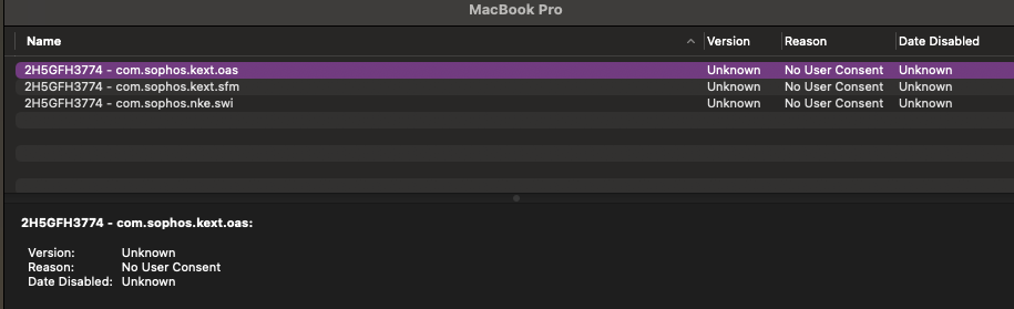

ngomes wrote: ↑Wed Jun 29, 2022 10:23 am [...] go to Apple menu > System Information > Software > Disabled Software and let us know what you find in there (if anything).

I did check that
its not in there.. control panel works.. and such too. but still other than the pop up menu and the virtual number pad.. no luck
Screenshot 2022-06-29 at 2.09.35 PM.png (50.84 KiB) Viewed 24672 times
