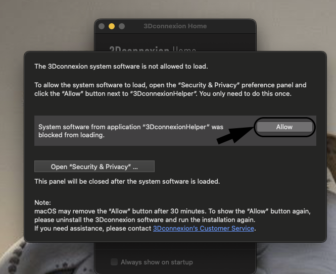

Just a heads up.. the driver is a bit buggy it installs after a few tries.. but then once you get to the allow button.. all i get is an OK that never goes away.
then the 3d home gives the same go to settings and fix this dialog over top of it. like with montery.
So looks like the same issues.. as last time.. - NOTE puck is working fine but buttons do nothing.

Got word from my colleagues. Here's what we have at the moment.
As far as we can tell, version 10.7.3 of 3DxWare 10 works as expected in "Ventura" Preview. The user interface to "allow" the system software has changed but, overall, it works similarly to macOS 12 and older.
Concerning the empty dialogue at the end of the "allow" process, we recommend reporting the problem directly to Apple as it seems to be an issue in the new system.

also for what its worth. i am still getting this.. error in 3d connexion home
Screenshot 2022-06-29 at 2.10.20 PM.png (199.43 KiB) Viewed 70598 times
