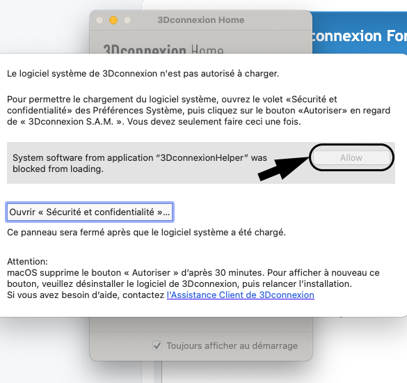

Re: macOS Sonoma
Finally, with this installer version I was able to install 10.8.6
It's still stuck on the 3d home connection window. Just throw it in the trash and the problem is solved.
But the shortcuts still don't work... And they worked with the good old spacepilotpro, we could program all the shortcuts key, with all the applications you wanted for years...
But not with the space mouse entreprise or the cad mouse.
When will you make a driver as good as the old one?

Re: macOS Sonoma
The system extension must be allowed by the customer before the 3Dconnexion software can function properly.
Only the user can "allow" the system extension even if the software is signed by 3Dconnexion's credentials and has gone through the notarization process. The restriction is imposed by the system.
Re: macOS Sonoma
Thank you, I know that.
But, no matter how many times I tell it that it's allowed to run, that window comes back every time I start it up.
I've just tried to uninstall it (with your uninstaller) and now I get this alert. See attached screenshot.
an idea?
an idea?
