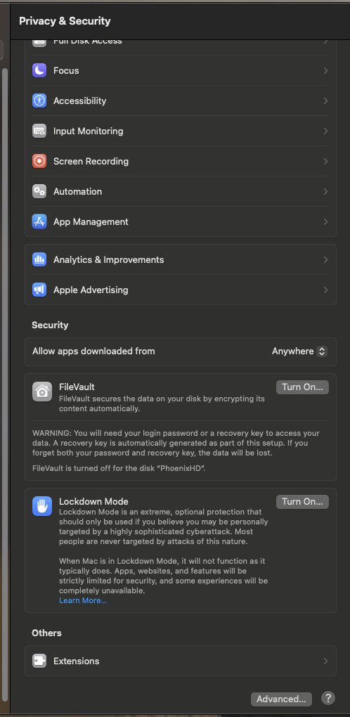

cjadams wrote: ↑Wed Jul 13, 2022 10:02 am i can confirm that the odd dialog didn't show up this time i installled and i only got one out of the 2 allows... note i even disabled gatekeeper and have the allow set to "anywhere"
Would it be possible for you to share a screenshot of the "Security & Privacy" pane?

ngomes wrote: ↑Wed Jul 13, 2022 10:28 am
Here

Thanks, cjadams. SIP is enabled, the driver installation succeeds but you never see the "allow" button in the "Security & Privacy" pane in System Preferences.
I'll have a word with my colleagues.
