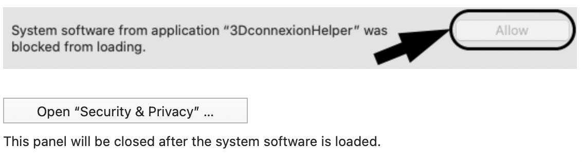

So, I ran the Driver install and when complete and after restart, I get the attached error. The problem is that the message described does not appear anywhere in system preferences...my system is managed by my company using JamF, is it possible that is why it is blocked?

garybart wrote: ↑Mon Jul 19, 2021 7:13 am So, I ran the Driver install and when complete and after restart, I get the attached error. The problem is that the message described does not appear anywhere in system preferences...my system is managed by my company using JamF, is it possible that is why it is blocked?
We can't comment about using JamF since we don't know what it will do.
If you're seeing the warning, then the system extension isn't yet "allowed". The "Allow" button is shown on the "Security & Privacy" pane in System Preferences. This manual step to "allow" system extensions is by design.

So, to be super clear, I confirmed with myIT team that Jamf is in no way blocking the install. There is absolutely no Message or an Allow button shown anywhere in Security and Privacy. I have uninstalled and reinstalled the driver. It is not working. Please help.

garybart wrote: ↑Mon Jul 19, 2021 11:22 am It is not working. Please help.
We can try but note we haven't seeing this before (system extension not available to be "allowed"). In other words, the issue may be isolated to your system. If others are similarly affected, then it should be easier to narrow down what's causing the issue.
Please check the status of the system extensions. Refer to the topic "Examine the Installed System Extensions" in this page.
