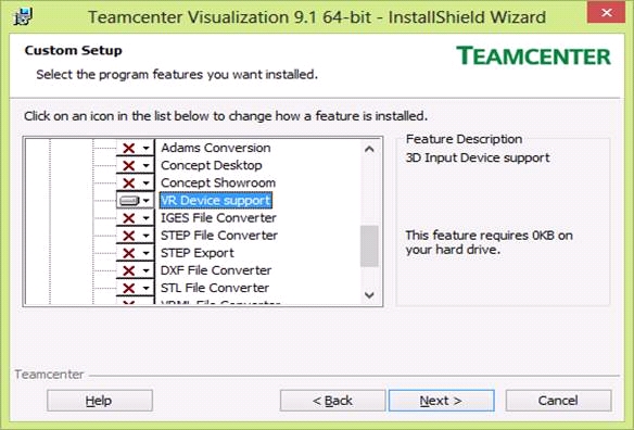

I have the exact same problem except I am using Catia v5 and Teamcenter Visualization Mockup. It is working flawless on CATIA. But in VisMockup rotations (in all 3 axis) are not working. I already tried both suggested solutions but none worked so far. Thank you in advance for your time.
Re: Teamcenter Visulization Mockup 10.1 no rotations
Hi mustafa10,
for Teamcenter the option is in the installation - you need enable "VR Device support". If it was not enabled in the original installation, the installer would need to be run again with the application closed to select "VR Device support".
- Attachments
- Teamcenter_VRDevice.jpg (133.39 KiB) Viewed 12401 times
