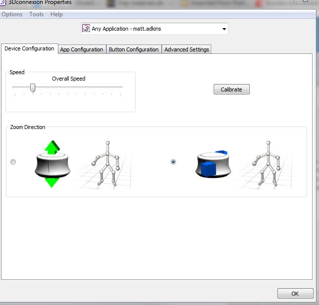

Okay all, I have used my SpaceNavigator for about a year on this PC. One day, I noticed that it wasn't working with any Autodesk products (Autocad, Inventor or Maya). I then decided to update the driver since I was purposely using an older version since I was having BOM crashing issues in Inventor 2013. The update unfortunately had no effect on the functionality for Autodesk software; the 3Dconnexion control panel is still visible and accessible, the SpaceNavigator still works with the 3Dconnexion demos and Google Earth, just not the Autodesk software (where it gets it's main use). I've attempted different drivers and usb ports, but those were in vain; also, I have noticed that the 3Dconnexion CP only lists "All Applications" in the drop down (see attached). It use to have the other software options, such as Inventor in there so that I could have different programs set up a bit differently.
Does anyone know what is going on and how to fix it?
