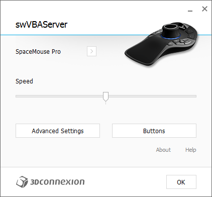

Now, it works in all programs except Solidworks. Opening the 3DxWare setting window in Solidworks results in this:

Have you checked if the add-in is active in SOLIDWORKS and is loaded? Go to Tools -> Add-Ins -> Other Add-ins and verify if you have an entry named "3Dcontrol" and if this has both boxes checked - one the left side and the right side (Active Add-Ins / Startup).
Let me know your findings.
sorry for not responding earlier.
