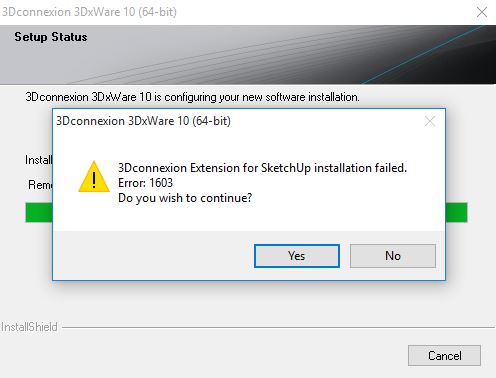

Tried again to reinstall and still failing on missing msi files (ran as administrator and tried on C drive) Getting error 1714 again as well as error 1603 on the same files. Please help - struggling to get a sketchup job done without the space navigator

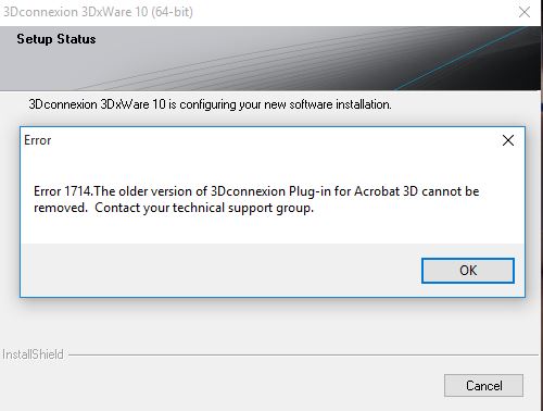

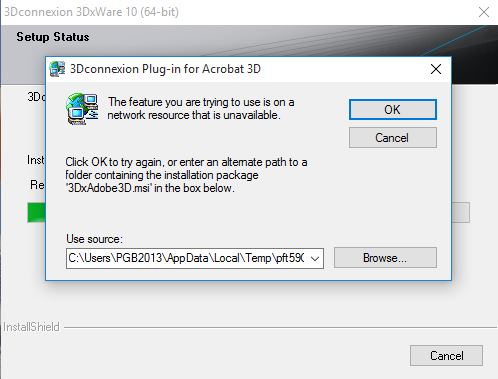

Re: Missing MSI Files
UtaSH,
Done a removal using FAQ28 although the DLL files to be deleted were not found. Reinstalled as administrator with networks and firewalls off - still no joy - error messages attached. Unable to run the command prompt routine you pointed me to despite many attempts to ensure I had the correct string. Still the same group of MSI files that are missing the most important to me being the sketchup file
Getting pretty desperate - takes ages every time I run through this process never mind being without the most helpful tool I have. Please help

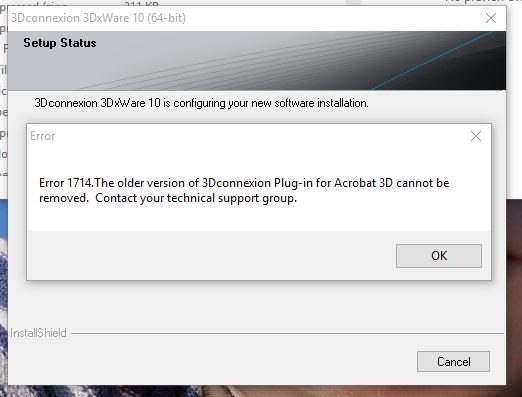

Utah,
Gone through the whole routine again and this is the message for each of the key add-ons including sketchup - see attached (even tried copying the temporary directory created during install and installing it afterwards) I have no idea which old version of the driver I had (I know you have asked other people to uninstall with an older version of your driver) Please please give this some serious attention - I have wasted so much time on this and am seriously missing the 3D space navigator. I have also fully uninstalled sketchup and reinstalled with no success
Exasperated
Exasperated
