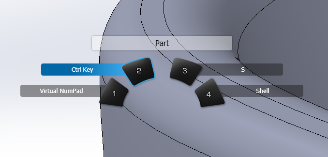

Would like to program the "2" button to be "Ctrl"
When I select "Ctrl" or "Keystroke" + "Ctrl" the button appears to be programmed. But when i use the button in solidworks a context menu pops up and the Ctrl functionality does not work.
Any thoughts?
ctrl button 2.jpg (85.92 KiB) Viewed 4773 times

Hello Righty -
Your screenshot shows the OnScreen Display that opens with a long press of Buttons 1-4.
UtaSH mentioned in this thread the option to turn it off is not pesent in the current driver but there is a request to add in in a future version.
The current software uses Buttons 1-4 for press and release commands with press and hold mapped to the OnScreen Display.

There is no GUI support for this but you can edit your %APPDATA%/3Dconnexion/3dxware/cfg/global.xml file to disable the OnScreenDisplay.
It needs to look like this:
Code: Select all
<Global Default="false" xmlns="">
  <Settings>
    <LogLevel>0</LogLevel>
    <LEDsEnabled>true</LEDsEnabled>
	<OnScreenDisplayEnabled>false</OnScreenDisplayEnabled>
  </Settings>...
