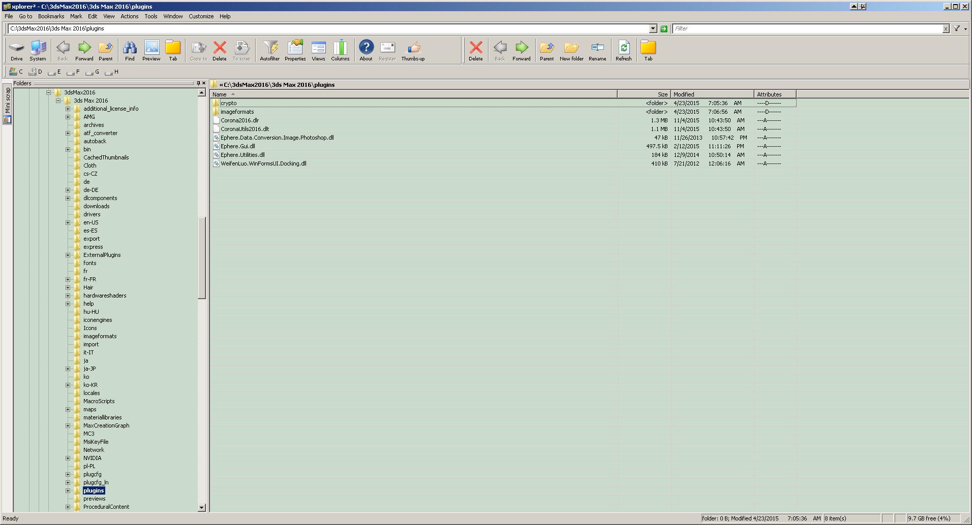

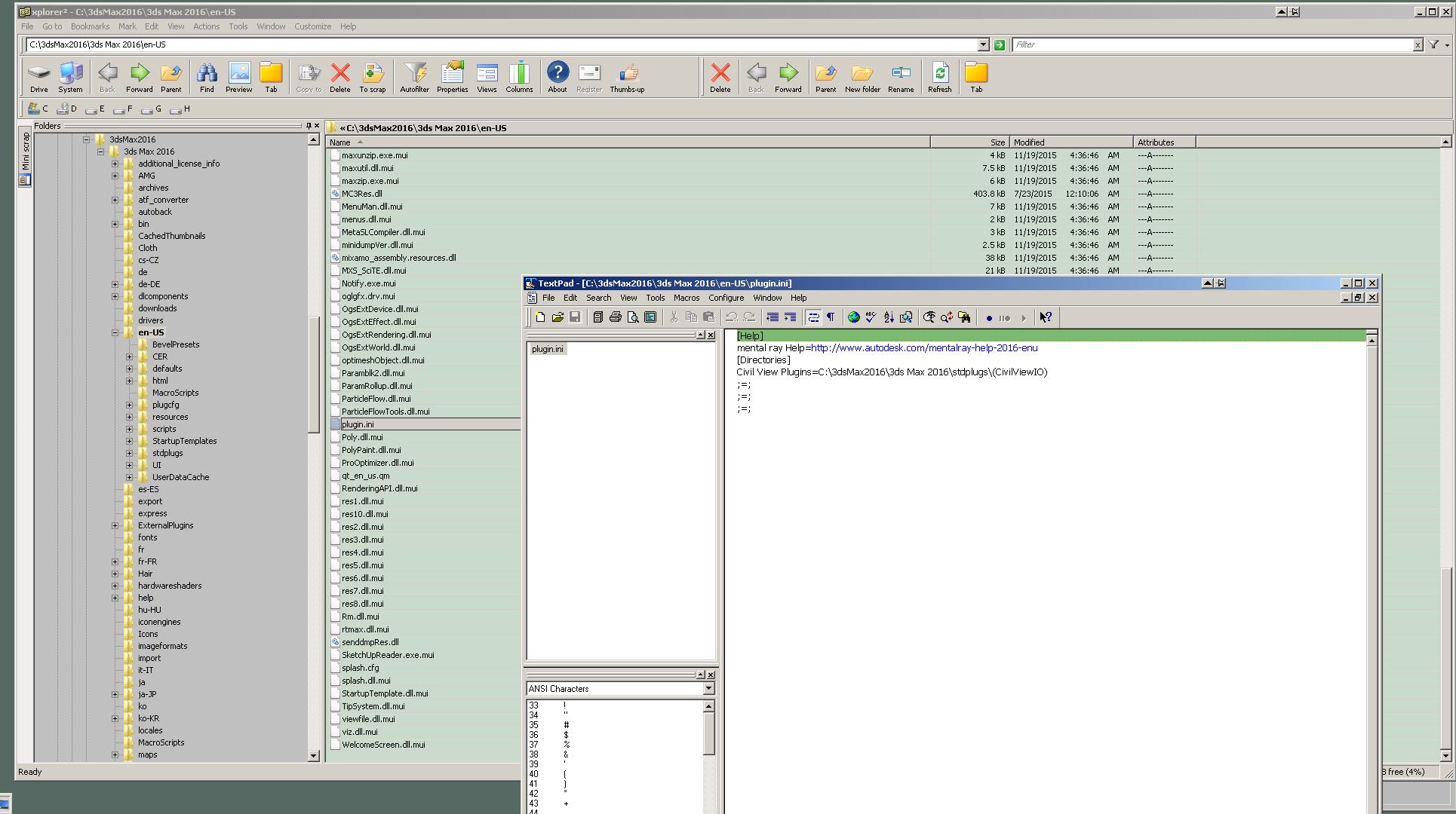

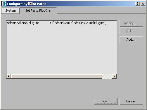

Attached are some screengrabs showing that the plugin folders/ini files (of this clean install of MAX2016) show no sign of 3DConnexion plugins.
3rd party plugins tab
plugins folder
plugins folder
en-US>plugin.ini contents
I'm glad the SpacePilot is working but its a mystery where the plugins/scripts are located as there is no INI setting I've found that is pointing MAX (in either MAX2014 or MAX2016) towards the ProgramFiles>3DConnexion> folders.

Hi Mike,
you should find the plugin files here: "C:\ProgramData\Autodesk\ApplicationPlugins\3DxStudio.bundle".
