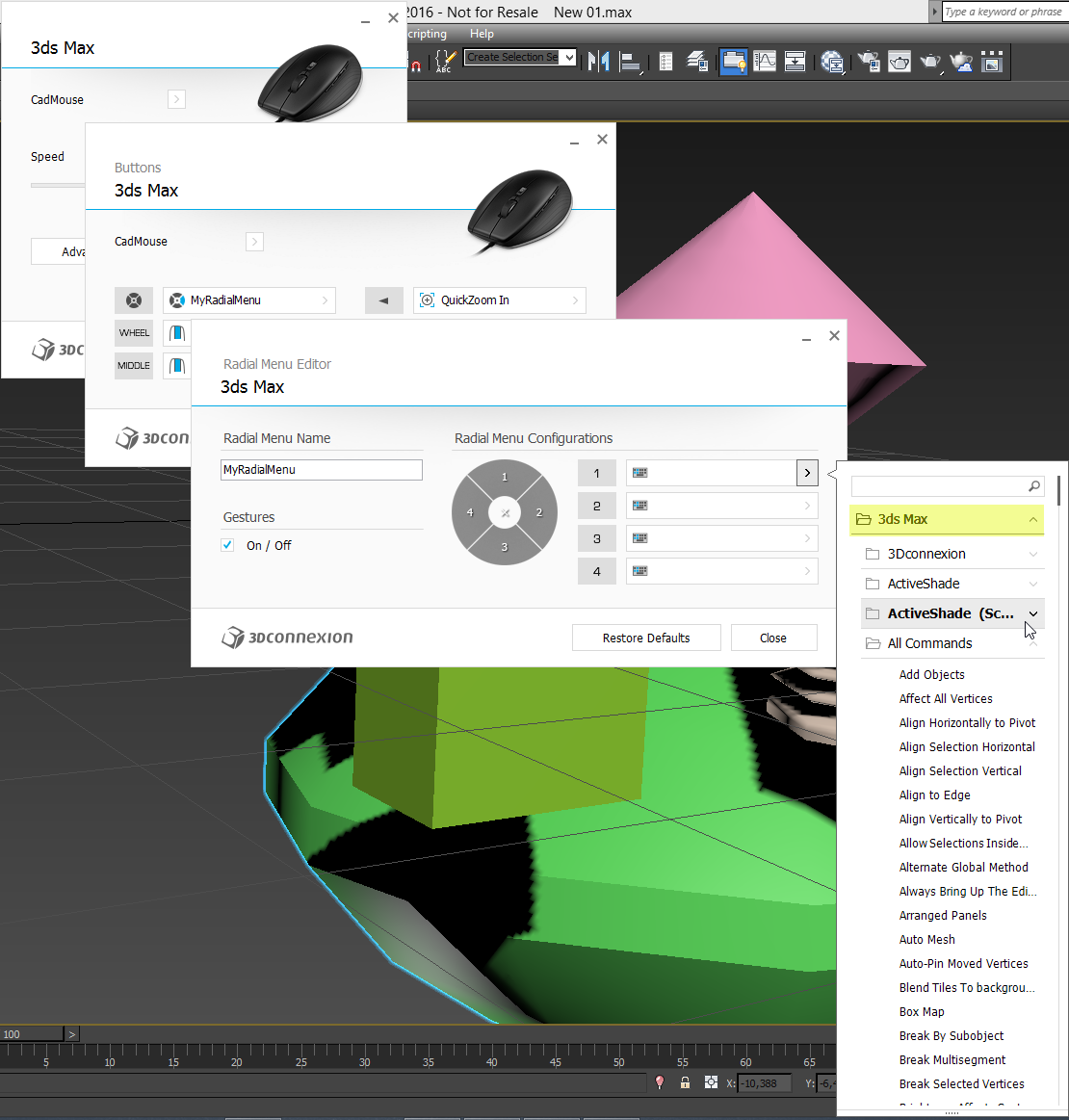

When using the RM Tools button on the cad mouse ,can the pop up menu items be configured to other settings in 3DS max ? currently its set to play animation, go to start frame, viewport visual style, and properties. I've looked all over and can not find a way to configure it.

Yes , you can use a custom shortcut instead of one of the pre-defined commands by scrolling down to 'Macros' and choosing 'New macro'.
Enter the key presses that generate your command - ie Shift| Ctrl | M , give it a name you will recognize in the macros list and save it.
Choose the RM section you want to map, scroll down to 'Macros' and choose your new command from the list.
For a 2 key press-and-release command you can use the 'Quick macro' function by entering the key presses in the command field [ like CTRL + A ].
The manual shows screenshots and details [Help |Cad Mouse Customization | Cad Mouse Buttons].

Barbara wrote: Yes , you can use a custom shortcut instead of one of the pre-defined commands by scrolling down to 'Macros' and choosing 'New macro'.
And you can use any 3dsmax functions from the list "3Ds Max":
Create Radial Menu.png (211.83 KiB) Viewed 5386 times
