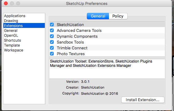

I am using Sketchup Maker 16.1.1.1451
3DxSketchup not listed in Extensions.
Is this a download?
Is this a download?

Re: Radial Menus ?!?!?!?
Hello sketchupforlife -
The 3DxSketchUp extension is not a separate download - it is part of the 3DxWare driver. It is installed during the 3DxWare installation rather then from inside SketchUp as some plugins and extensions are.
SketchUp must be closed during the 3DxWare install so the extension can be added.
When the 3DxWare install completes, restart SketchUp and open 3Dconnexion Preferences | Configure : SketchUp | Buttons to map a radial menu to a button on your device.
If this does not match what you are seeing , please let us know what is different and which device and driver you are using.
Sorry for the delay. Thank you Barbara, I have done as suggested and it has worked.
