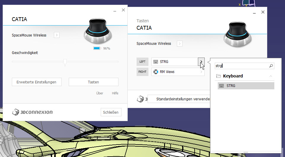

the driver saves the settings for each application separately. To determine for which application you want the changes you have to make sure that the application is running and is the active window. The driver shows the name of the active application at the top of the window. It should look like this:
Catia V5 + SpaceMouse Wireless - Left button set to Ctrl
If this is what you see I suggest you clean your settings for the 3D mouse. See here how to do that. Let me know if you could solve your problem.

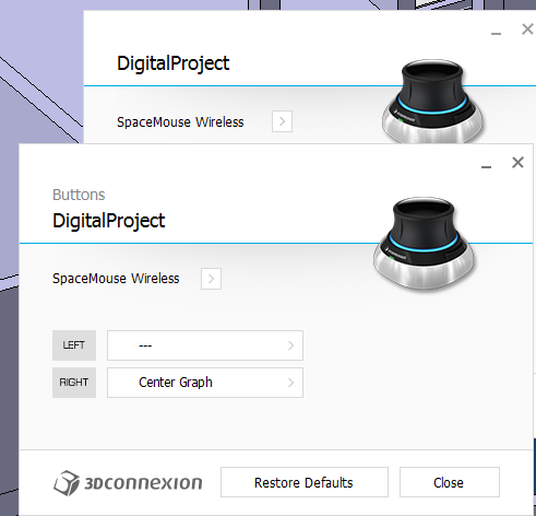

When I do that the mapping work for the session right after i set it up in the driver , however once i restart the software , the mapping doesn't work anymore. or it switch to the setting of the catia mapping.
Yesterday i set it up in the driver, however today the set up is gone, do I have to set it up at each startup ? Or is there a way to shut off catia mapping, so only the driver controls it ?
Thanks
Space mouse button3.PNG (47.28 KiB) Viewed 11103 times

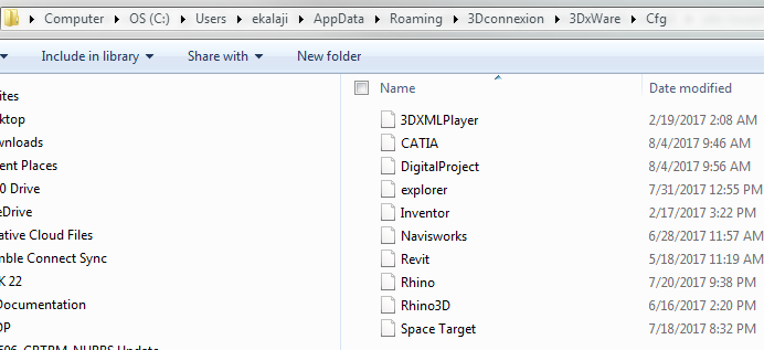

the settings that you make are saved in your AppData folder in C:\Users\<username>\AppData\Roaming\3Dconnexion\3DxWare\Cfg.

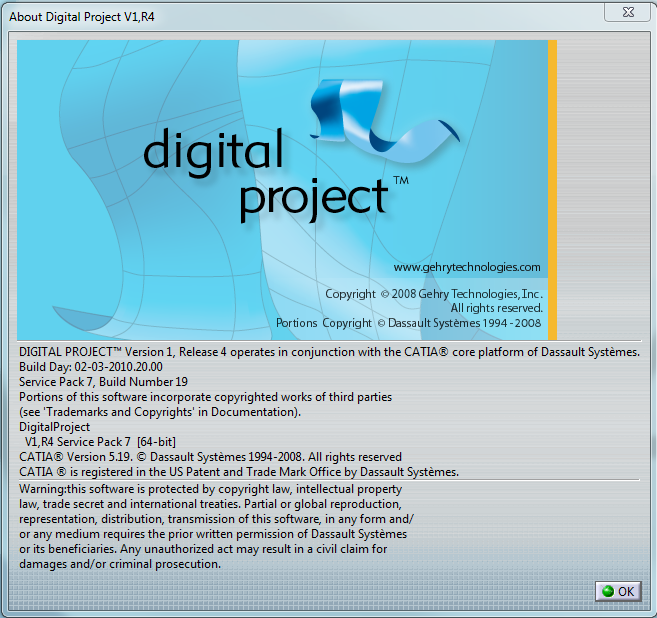

Sorry i should have clarified this ,So Digital Project is a software built on Catia V5, It is the architecture edit of Catia, developed by Gehry Technology.
I checked the location you mentioned and i saw a file in the name of digital project, i guess this contain the settings.
however for some reason, every time i restart the computer or restart just the software, I have to set up the Ctrl button again.
Space mouse button4.PNG (141.1 KiB) Viewed 11089 times
Space mouse button5.PNG (34.02 KiB) Viewed 11089 times

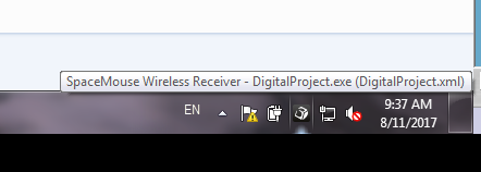

When you have Catia + Digital Project open please move the cursor over the little black/white 3Dconnexion icon in the system tray and wait for the little window to show up. It will tell you which 3Dconnexion device is attached, which application is currently active (Catia or Digital Project?) and it tells you which file it uses to save the changes you make.

This is what the black icon says.
Space mouse button6.png (22.37 KiB) Viewed 10932 times
