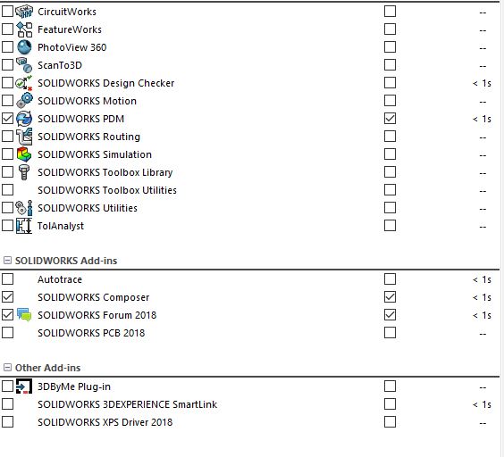

Also, isn't there supposed to be an add-in?

you have to install the driver for the 3D mouse after you installed SOLIDWORKS.
Next make sure you are starting the driver and SOLIDWORKS with the same user. See here.
