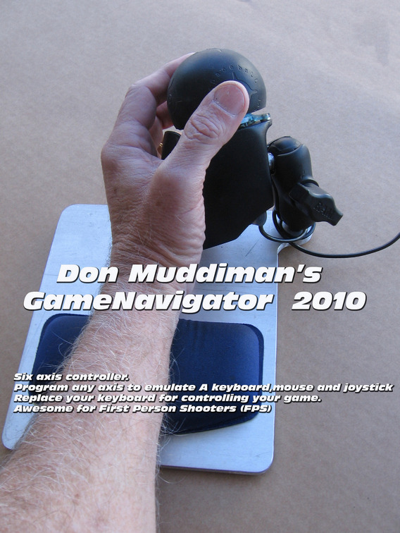

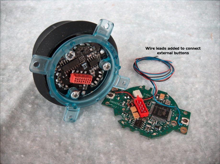

I removed the electronics form a Spacenavigator and fabricated a custom grip. I"m using the RBC9 driver and software on Windows 10 for custom gaming setup.Image. I've been using this setup since 2010.

Ok, you have my attention. :)

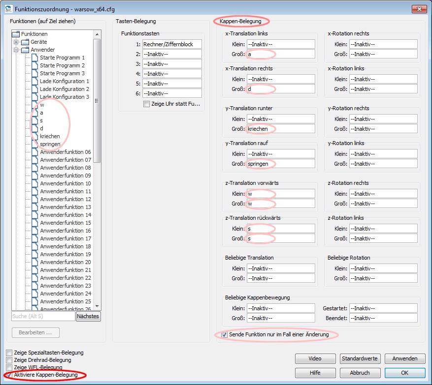

After the RBC9 driver did not work for me under Windows 10 ( or I did not manage it :wink: ) i got a space mouse from SpaceControl.
They have a really good driver where, as with RBC9, you can set everything individually, even keys on axes
Personally, I find the hardware of 3dconnexion better, ergonomic for my Hand, so I'm really glad that the RBC9 driver is running again :D

I agree the SpaceNavigator in its current physical configuration and software does not lend it to being a good game controller and/or a 3D controller. Having to hold your hand above the knob in an unnatural position is uncomfortable and hard to control fine moments using hours on end. That's why I redesigned the physical configuration of the controller (See previously posted images). In my configuration, you can adjust the ball/knob to rest in your hand at a normal comfortable position that can be used for hours at a time without fatigue. It also allows for to control finer moments of the controller. As being slow I don't understand the remark. The SpaceNavigator responds instantly to commands, maybe the software interface your using is causing a delay. I use the SpaceNavigator with the RBC9 software/driver to emulate the keyboard commands such as WASD, run, walk, crouch prone, jump, reload, etc. For me, this allows better game immersion using a slight touch of the SpaceNavigator as to hammering the keyboard keys. Until you have tried it you can't appreciate how natural this feels using it in combination with a mouse. Push the ball/knob slightly forward, you walk, push further you run. That's why being able to set slices is important and the RBC9 software supports that feature as 3Dconnection does not. RBC9 seen the potential of the SpaceNavigator controller leading him to write the software and driver. My physical configuration is a spin off the SpaceOrb using one hand instead of both. For me its the best configuration for gaming.
