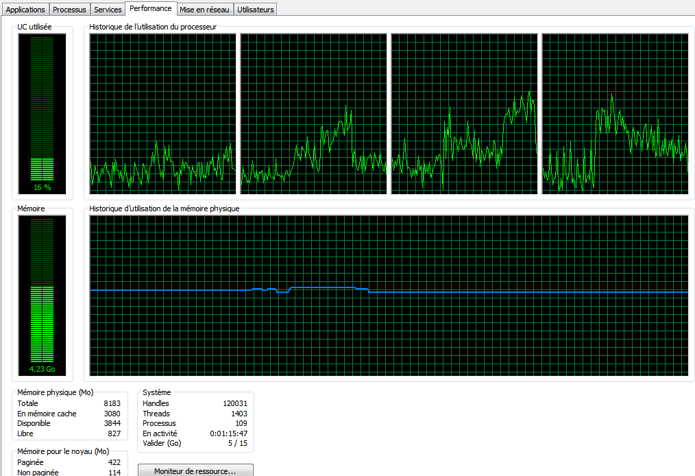

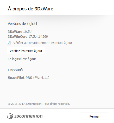

Hi, i have exactly the same problem with solidedge ST10 and a space pilot pro. When i start solidedge it work fine but after some manipulation (10 minutes) i have this problem (need to restart my pc to correct it !). When i use my standard mouse i have no problems (the movement is very fluid) !
my config :
- solidedge st10 mp2
- windows 7 64
- nvidia quadro fx3800
- corei5
- 8 Go RAM
3d connexion :
When i use the space pilot :
Tested with 3d connexion viewer working fine (very fluid). Can you help please ?
