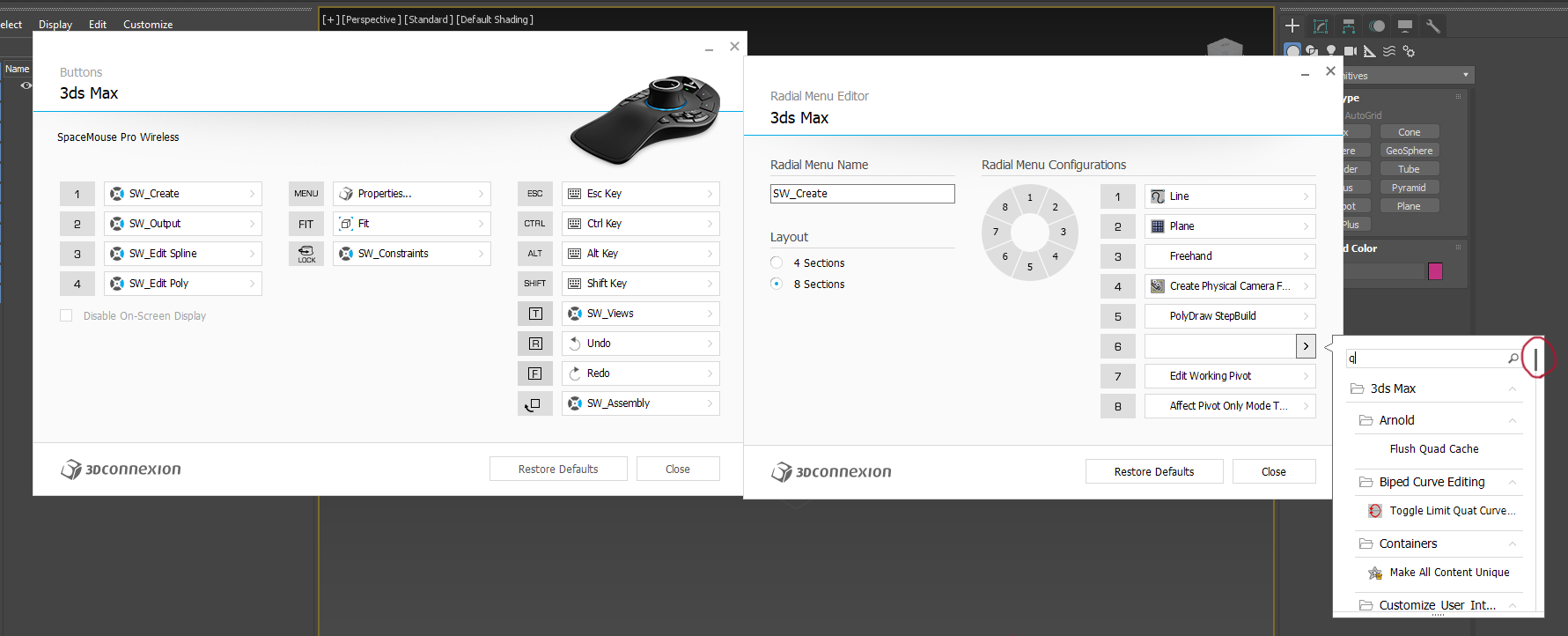

Thanks for the heads-up about the new driver and solving multiple bugs, much appreciated. I've been using it for a week and it works like a charm, it's by far the most stable driver for 3ds Max sofar. Concerning the hiccups, they do still persist, however, they do no longer freeze or crash the driver. I do believe it has to do with the amout of hits after a type-in search, manually selecting an item is fluid. For me typing "se"/ "po"/ "ar" causes such a hiccup, whereas "q" does not ("qp" is instant with only one hit). I added two screenshots below to show the difference in search hits and my settings (all 8 section radial menus).
The command search needs to be looked at. We haven't yet tried to optimise it since we're planning to do an overhaul on the driver back-end and until that work is done, there's little gain to be had.
In the mean time, we have created the enhancement request WIN-132 to see if we can improve the search usability.
