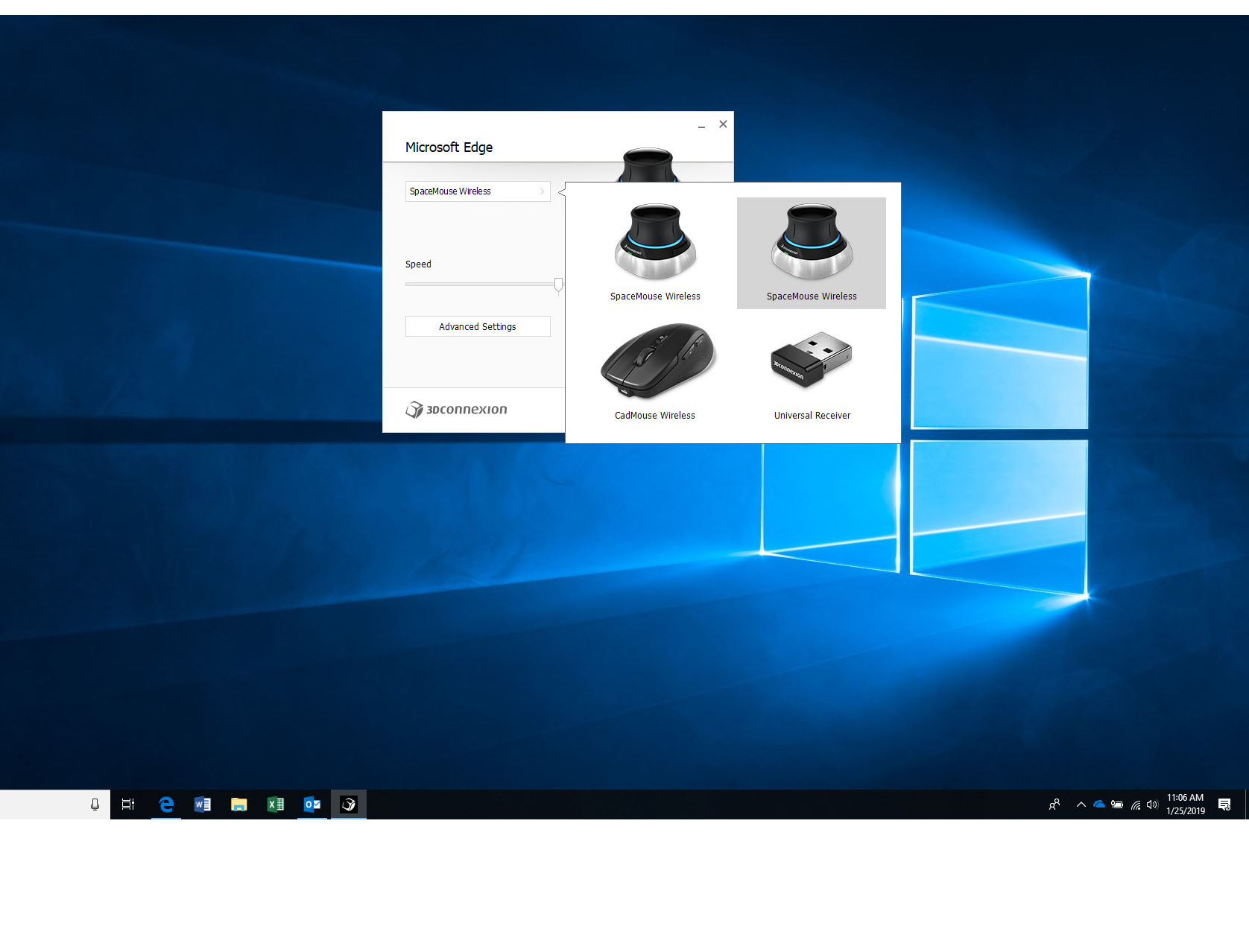

as seen in attached image, there are two instances of spacemouse wireless. How do I delete one?
- Attachments
- 3dconnexion.jpg (168.2 KiB) Viewed 2027 times

the picture looks like you have paired the SpaceMouse Wireless with the Universal Receiver and still have the original receiver ("dedicated receiver") connected.
The SpaceMouse Wireless is now delivered with the 3Dconnexion Universal Receiver, but brefore it had a dedicated receiver which could only connect with a SpaceMouse Wireless. Our new receivers that we have since we launched the CadMouse Wireless can connect with more than one device and with different device types.
The second entry for the SpaceMouse Wireless should disappear once you unplug the original receiver. (Or if you diconnect it from the Universal Receiver.)
