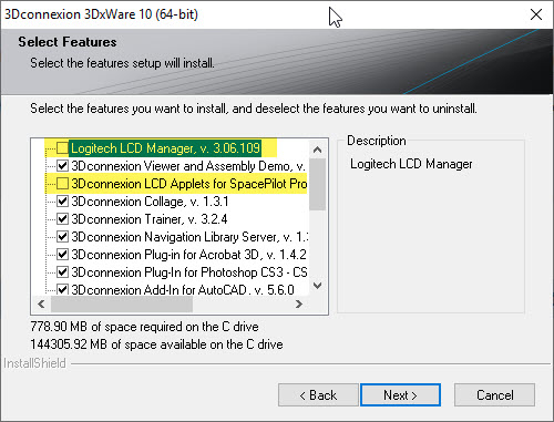

The SME does not need any Logitech drivers and it doesn’t even have an extra LCD driver – the LCD of the SME is handled by the 3Dconnexion driver. So there will be no interference with any newer Logitech drivers.
When installing our driver package then please uncheck/don't install the LCD manager so that you won't get into problems with any newer Logitech driver. I've attached a screenshot :)
