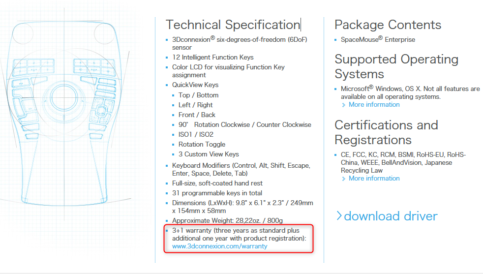

Have you registered your device within 90 days after your purchase? If so, it's 3+1=4 years of warranty.
3+1 warranty (three years as standard plus additional one year with product registration):
https://www.3dconnexion.com/products/sp ... prise.html

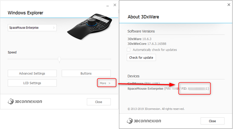

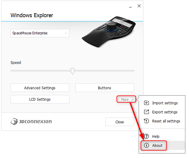

Look at the screenshots below. You can find the PID of your SME on the 3DxWare driver's Menu, hit the MENU button on your spacemouse enterprise device, and click 'more >', and click 'About', your device's PID should be displayed there. Now try to register your device, and try to find your device purchase receipt/invoice or screenshot of online purchase record to justify that you're the real end buyer of your device.
