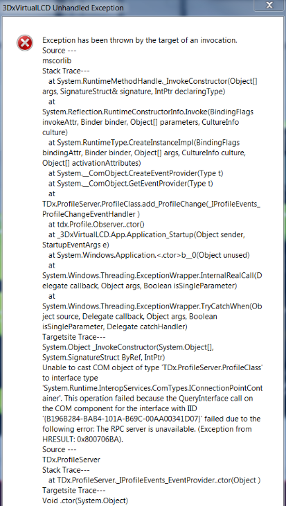

I have looked at several different post about this error and they seem to all say different things than mine. How do I correct my issue. It appears a uninstall and re-install doesnt work.

jmcbee wrote: Mon Oct 28, 2019 5:04 am I have looked at several different post about this error and they seem to all say different things than mine. How do I correct my issue. It appears a uninstall and re-install doesnt work.
From what I see in your screenshot, there's a problem with your Microsoft .net framework, probably you need to install .NET Framework 3.5 SP1 to your windows 7 sp1 system.
http://download.microsoft.com/download/ ... etfx35.exe
Give it a try, and tell me the final result.
