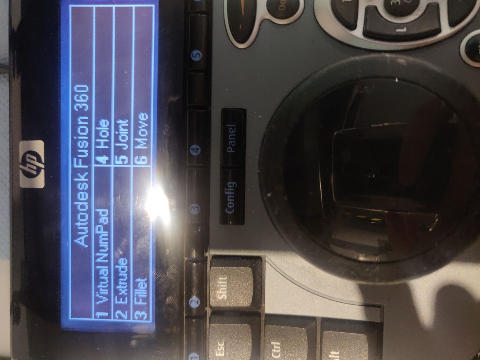

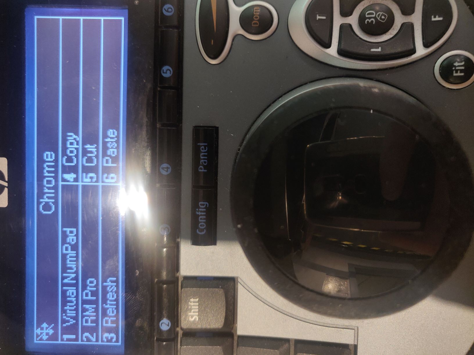

2. this is the real problem, I cant seem to customise the buttons they just come up with 1 = virtual numpad 2=2 3=3 4=4 5=5 6=6. When i try and change the buttons in the configuration it saves it but the button doesn't work and the display stays the same. I have attached screen shots to show this.

Re: Old Spacepilot button configuration
Could be a cfg format issue.
Make sure you don't try to mix in plugins/cfgs from a more recent version (e.g., the current version).
The driver's log file may say something about what is going wrong.
Turn it on with the 3Dx systray icon. The file is: %localappdata%\3Dconnexion\3DxWare\3DxService.log.
I'd save all the user cfgs off somewhere, and then delete them (%appdata%\3dconnexion\3DxWare\Cfg. See if that resets it to the point that it starts working again.
