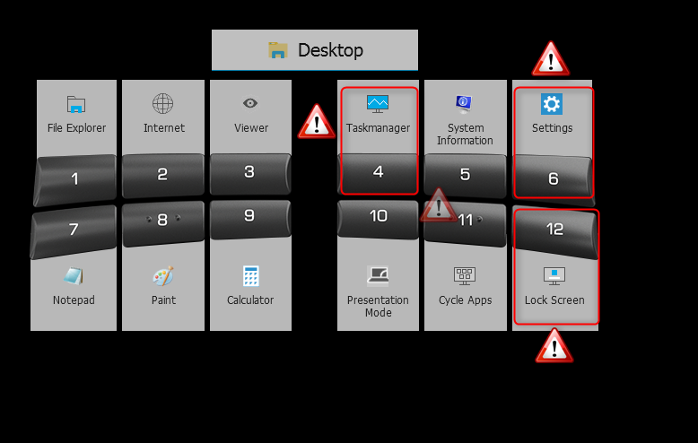

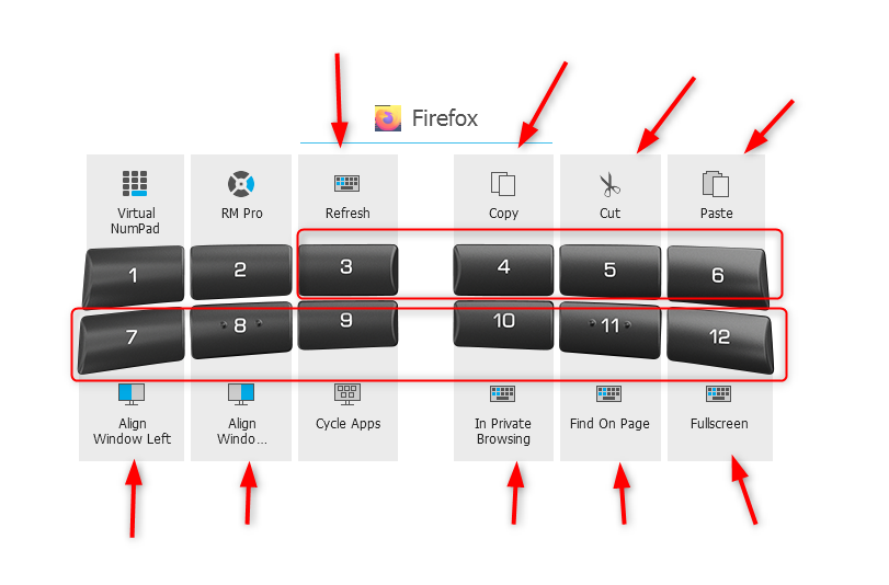

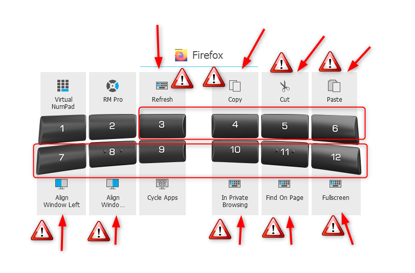

After upgrading to 3DxWare v10.6.6 with clean installation, there apparently seems like the number keystrokes in SpaceMouse Enterprise don't support Firefox 75.0 64bit, except number 1 and 2. 3-Refresh/4-Copy/5-Cut/6-Paste/7-Align Window Left/8-Align Window Right/10-In Private Browsing/11-Find On Page/12-Fullscreen are all not functioning.
I also tested it on Microsoft Edge v81, as well as Windows 10 Explorer, Align Window Left/Align Window Right not working.
If there's no active application window, the 4-Taskmanager/6-Settings/12-Lock Screen keystrokes are dead.

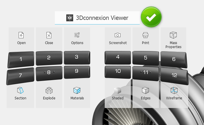

While in 3Dconnexion Viewer, all 12 number keystrodes are working without any problem.

I just took an SME, launch Firefox 75 on my dev machine and selected the text on the browser's address field. I then used the SME buttons 5 and 6 to "cut" and "paste" the text. It seems to work just as expected: the text is deleted and then copied back in, just as if the user had done a "Ctrl-X" shortcut followed by "Ctrl-P".
