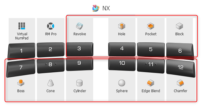

Someone in the local chat group for 3Dconnexion products complained that the latest 3DxWare v10.6.8 doesn't solve the unresponsiveness of Intelligent Function Keys in SME when in NX 1872 series release 1892.3800(release date May 2020), in 3D modeling workbench or environment. 10 out of the 12 Intelligent Function Keys for NX modeling application commands are not working. He said the 3-12 modeling commands(Revolve, Hole, Pocket, Block, Boss, Cone, Cylinder, Sphere, Edge Blend, Chamfer) can not be invoked. Since his English is poor, he asked me to report SME compatibility issue with specific NX release build here.

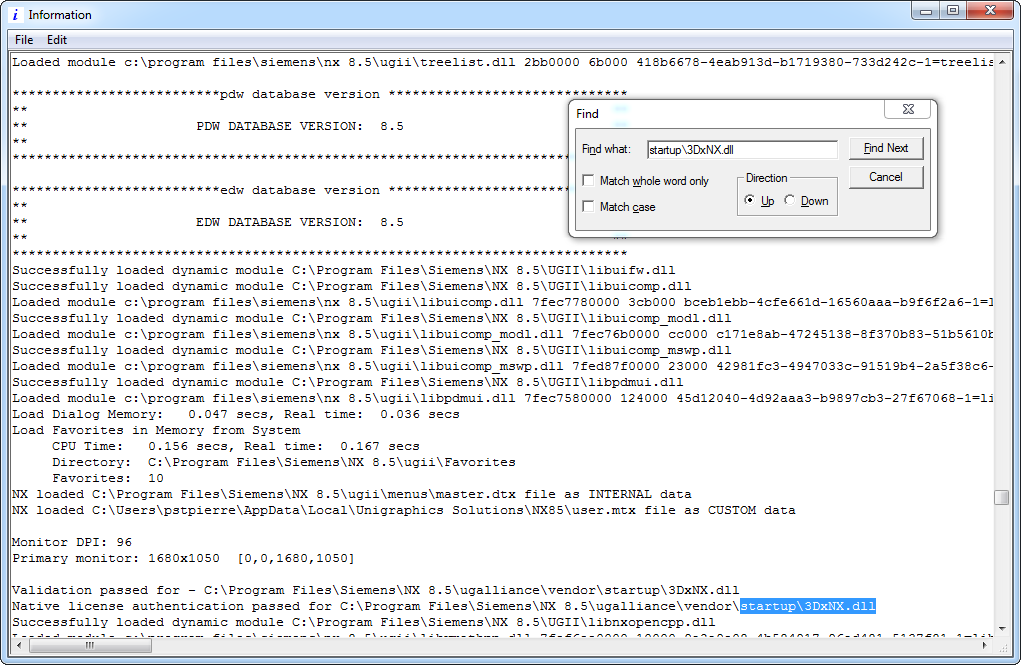

Please ask to check if the plugin - 3DxNX - is loaded in NX. Searching the NX log file for "startup\3dxnx.dll" will show if the plugin is loaded.
  1. In NX select Help -> Log File
  2. Search by pressing Ctrl+F for "startup\3DxNX.dll". This shows if the 3DxNX plugin loaded.

Well, I managed to copy all folders and files in C:\Program Files\3Dconnexion\3DxWare\3DxNX\ugii_dir\v1872 to C:\Program Files\Siemens\NX1872\UGALLIANCE\vendor and switched his NX UI to English and took screenshots via remote control tool Teamviewer to his desktop as he pressed one of the intelligent function keys.

The 3DxNX plugin is loaded in NX.

Successfully loaded dynamic module C:\Program Files\Siemens\NX1872\ugalliance\vendor\startup\3DxNX.dll
Successfully loaded dynamic module C:\Program Files\3Dconnexion\3DxWare\3DxNX\ugii_dir\v1872\startup\3DxNX.dll
After removing 3DxNX.dll and other 3DxWare stuff from C:\Program Files\Siemens\NX1872\UGALLIANCE\vendor, there is only one string in the log:
