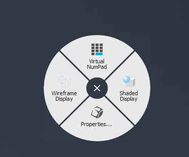

I cannot save the button config for Autodesk Inventor, it goes to default after a while:
why? :shock:

the settings are saved in your %APPDATA% folder (%APPDATA%\3Dconnexion\3DxWare\Cfg). Is this folder emptied "after a while" by a script?
Are you running Inventor and the driver with the same privileges? See here.
