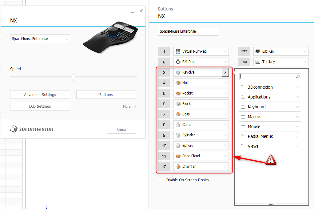

No, I mean when the 3DxWare driver v10.7.0 is installed and running while SolidEdge is running as the active application in focus, call out the 3DxWare control panel by hitting the MENU button on your SpaceMouse Enterprise hardware, actually the 3DxSmartUi.exe process.
The problem you described is what I once reported in another thread in this forum, the lack of application-specific sub-menu/sub-command list from the Buttons configuration window, in my case of testing, Siemens NX v1880, while in your case, it's Siemens SolidEdge ST9 with MP13.

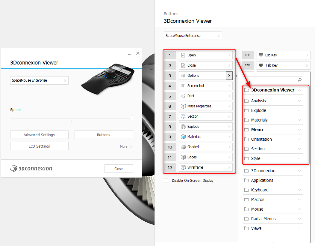

Check out the screenshots below, the 3Dconnexion Viewer is detected by 3DxSmartUi.exe process and 3Dconnexion Viewer application is showed in Buttons panel commands mapping section with sub-commands for reassignment. The problem is that 3DxWare v10.7.0 is claimed to support NX v1872, v1899, v1926, but not the kind of maintenance release version between, in my test case, v1892 and another guy's v1880(all belong to v1872 major release). I believe the problem is the same one happened to your SolidEdge ST9 with maintenance pack 13, after many maintenance packs, the SolidEdge ST9 just lost the ability to be fully detected by 3DxWare v10.7.0. I suppose the initial SolidEdge ST9 with no maintenance pack should be fine with 3DxWare v10.7.0.
So far, I don't think 3Dconnexion driver developer(s) will investigate the issue what we're experiencing right now, they simple don't have enough resource to cover this specific CAD workbench/environment incompatibility issue.

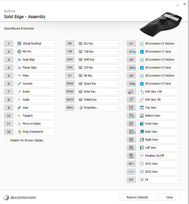

I just tired calling out the control panel via the MENU button on the hardware which brings up the button form as usual.
The Solid edge environment is detected by the 3DxSmartUi and the menu form shows as expected for the solid edge environment.
Image 4.png (74.33 KiB) Viewed 6538 times

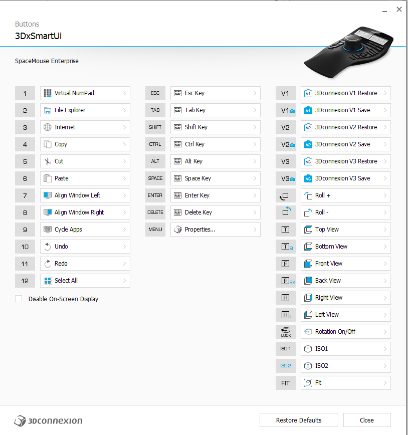

The problem is that as soon as I click on the 3DxSmartUi form to set what a button does in Solid edge or any other program (Excel, chrome, etc) that program becomes deselected and the 3DxSmartUi is the selected interface.

Based on this not working on any program, its not purely a solid edge issue. Also the old version on my previous computer still allows me to set the buttons via the 3DxSmartUi with solid edge ST9 MP13, excel etc.
