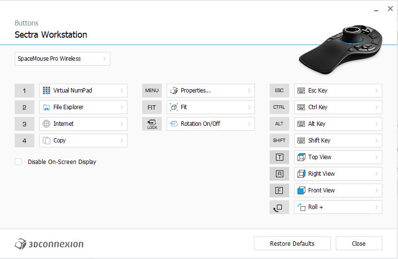

With your software and without the cable, the buttons have only your functions:
1: Keypad
2: Explorer
3: Internet Explorer
4: Copy

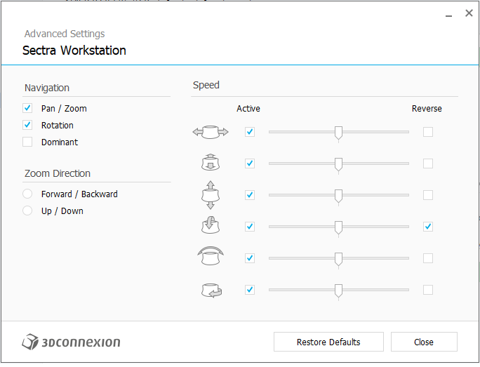

I have attached pictures showing the settings of the mouse.
Is there any setting I could try to get the wireless mouse to work perhaps even with your software installed?

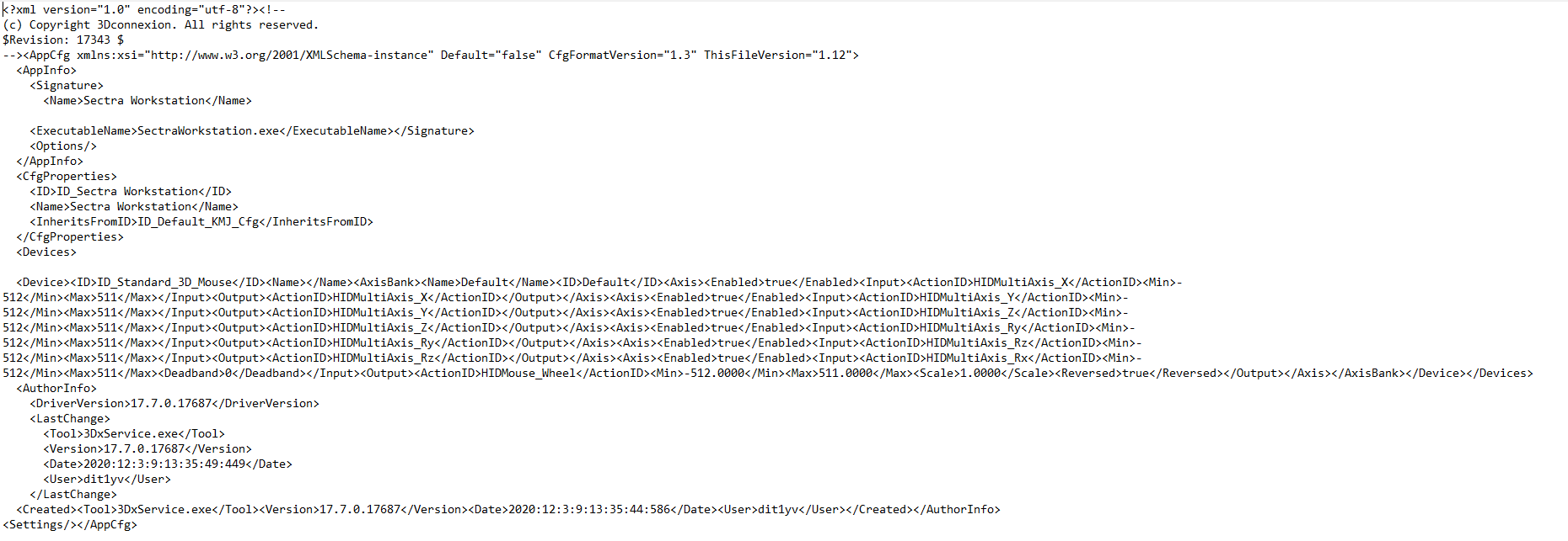

I attached the notification from the mouse software and the xml I think is used by Sectra to communicate with the mouse (had to make them both pictures, as I can't add txt or xml).
What do you recommend I do as a next step?

This shows the driver doesn't recognize the app as a 3D mouse-supported app. Probably rolling the cap (like a motorcycle throttle) sends MouseWheel events to the app. This will do whatever a 2D mouse mousewheel does.
Try contacting Sectra tech support to ask them what API they use to support the 3D mouse. They are not going to know, but if they are helpful they can ask development and get back to you. If not, we can do some experimentation to try to find out.
You can start by telling them that the SpaceMouse Pro Wireless buttons don't work. That's a bug.
