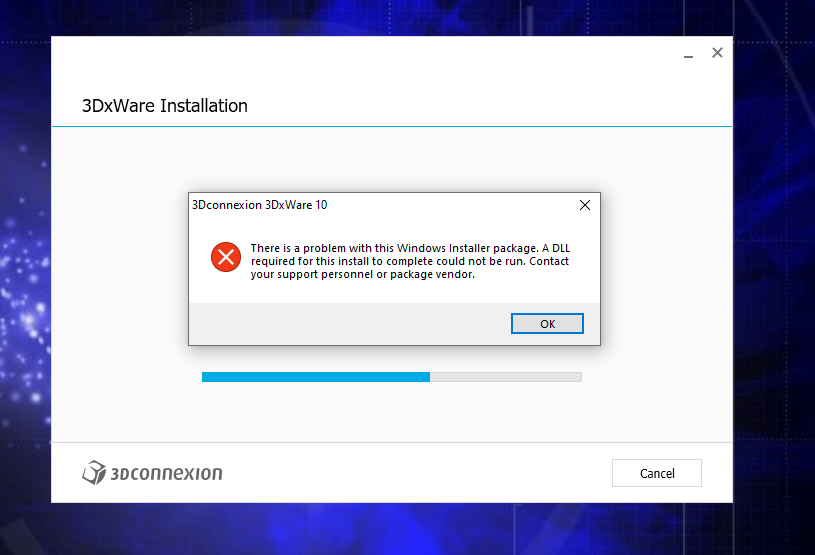

mxwrench
Posts: 1
Joined: Sat Mar 13, 2021 9:52 am
Re: Clean uninstall
Post by mxwrench »
I am having the exact same problem. I too have submitted a ticket with support team.
How long typically do they take to reply?
I tried removing thru windows program manager, tried repairing and ununstalling using 10.4 install file, removed old registry components, still nothing.
I'm getting
3d connnrxion install fail image.PNG (234.69 KiB) Viewed 6292 times
ngomes
Posts: 3460
Re: Clean uninstall
Post by ngomes »
mxwrench wrote: ↑Sat Mar 13, 2021 9:58 am removed old registry components,
That may have been what caused it. Windows Installer (the framework used by installers) relies on a consistent Registry. When this information is deleted, the framework cannot continue since the cached information is gone.
Try installing the old driver. That will restore the deleted data. You can then cleanly uninstall the software and try to install the new driver once again.
UtaSH
Posts: 3754
Location: Munich, Germany
Re: Clean uninstall
Post by UtaSH »
mxwrench wrote: ↑Sat Mar 13, 2021 9:58 am I too have submitted a ticket with support team.
Hi mxwrench,
you opened the ticket on a Saturday and got a reply on Monday morning. This is how the response time should be. 8) :wink:
It seems you were able to solve the problem by installing the older version of the driver. If you now reboot, uninstall the old version and reboot then you should be able to install the latest version. :)
