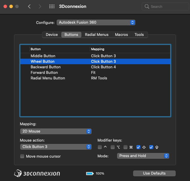

For Compact CAD mouse I've had this problem when using the bluetooth connection only on Catalan. The wired and Universal receiver worked fine when set up as per below
what used to work on universal receiver
Screenshot 2021-10-05 at 16.43.20.png (60.91 KiB) Viewed 13875 times
Now i've updated to Big Sur that doesn't work for any of the connections. for some reason it wont recognise a shift key modifier. i tried setting up macro etc but i can't find a single button method to get it to orbit.
so you can either set up the middle button/wheel button as button 3 and press shift on your keyboard or set up the wheel button as a TYPE KEYSTROKE SHIFT, the middle button as button 3, and press both at the same time. see below.
two button orbit set up
Screenshot 2021-10-05 at 16.51.06.png (58.64 KiB) Viewed 13875 times
3Dconnexion need to get the modifiers to work properly on bigsur ASAP to get back to a single button orbit.
