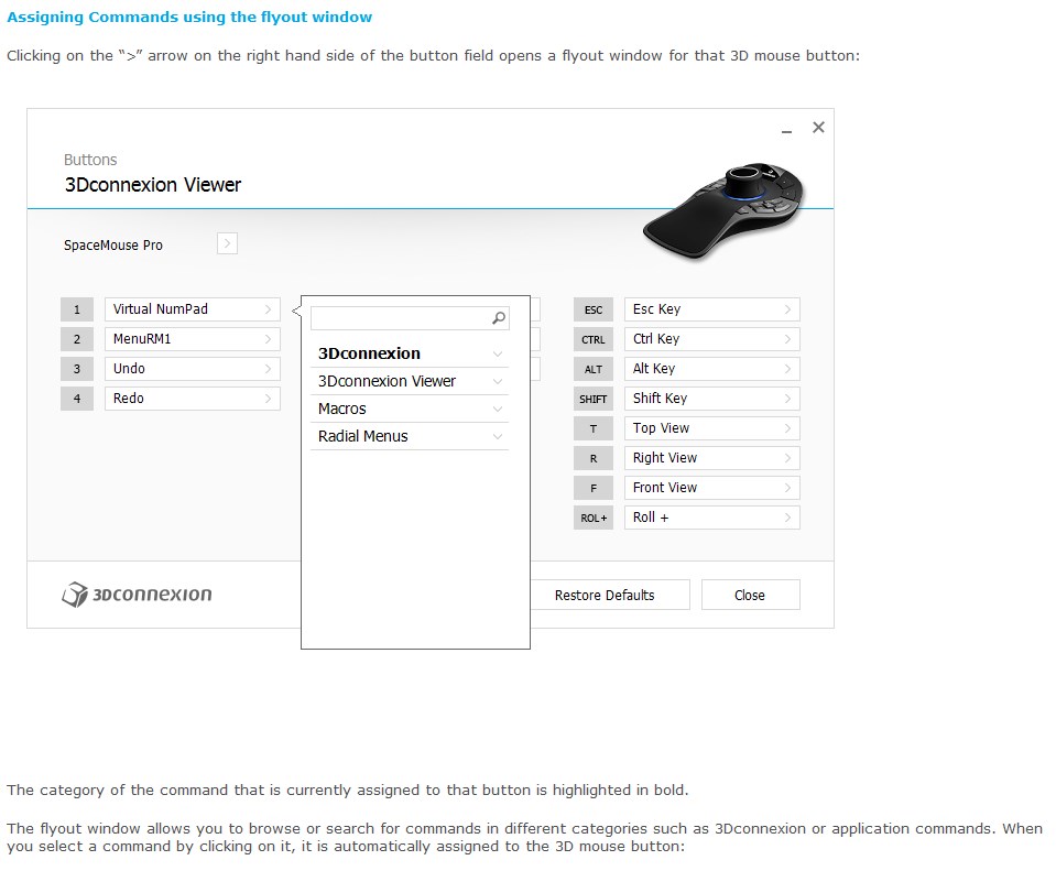

When the NX application window is active and in CAD/modeling workbench/mode/module, press the 'MENU' button on your SpaceMouse Pro Wireless, then click the 'Buttons' to call out the 3Dconnexion button mapping panel, you can assign NX modeling commands to the 4 numbers at the left side of the window. Take number 4 for example, 3DxWare 10.7.4 supports NX 1980 initial release, then you should be able to assign NX command using the flyout window. In the flyout window, if NX 1980 is really supported, there should be a NX category of command for you to choose from a submenu of NX commands.
flyout window.jpg (93.38 KiB) Viewed 3025 times
