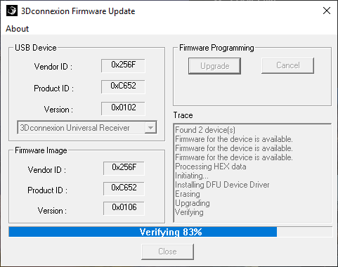

Try to update the firmware of the universal receiver or the SpaceMouse Wireless itself when plugged into PC USB port via cable, here's the download link to 3DxWare firmware update tool:
https://www.3dconnexion.com/technical_s ... r17928.exe
firmware update process.png (14.57 KiB) Viewed 14836 times

Thanks but it's wired

Is there a firmware for wired version?

lensdigital wrote: Wed Dec 08, 2021 5:09 am Is there a firmware for wired version?
The same firmware update tool applies to wired version as well, just try it.

luping wrote: Wed Dec 08, 2021 5:12 am The same firmware update tool applies to wired version as well, just try it.
Didn't work for me... Couldn't find device...
