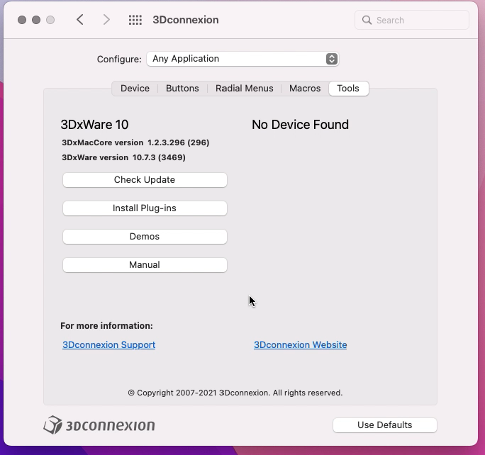

The other is that it randomly "loses connection" (even though it's wired) for a couple of seconds at a time. It can be seen on the screenshot as "No Device Found". Then it will automatically reconnect and the settings will show "CadMouse - Firmware 1.06" again. This is very annoying and basically makes the mouse useless for work.
Screenshot 2022-06-28 at 12.27.34.png (113.12 KiB) Viewed 3838 times
Try wiggling the USB cable and connector to see if there are any bad electrical contacts.
