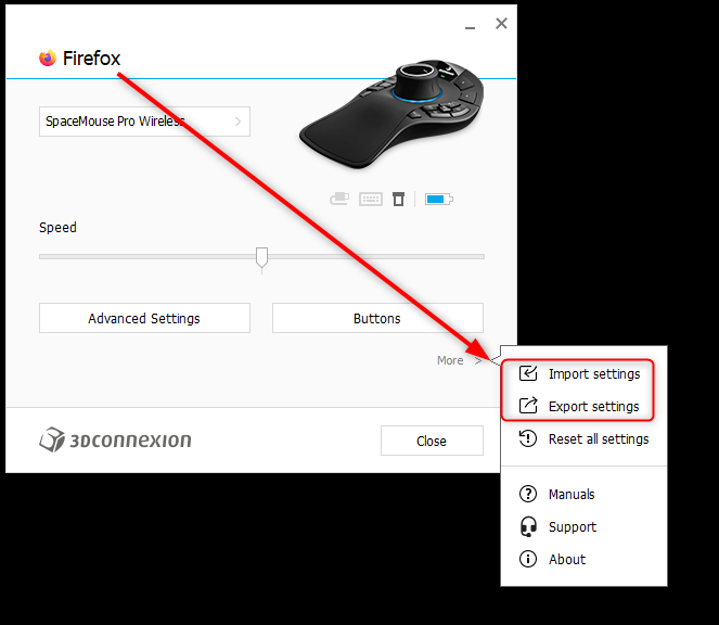

You can't have two profiles for one application at the same time, e.g. not possible for two profiles for AutoCAD 2023 as active for 3DxWare to handle. However you can configure one profile at a time for one application and export the configuration/settings, and make several profiles after that, when you want a specific profile to be loaded by 3DxWare, you can import the specific profile and get it loaded, it's a manual process, not automatic.
luping
Posts: 1114
Re: A technical subjection / Une sujétion technique
Post by luping »
See screenshot.
