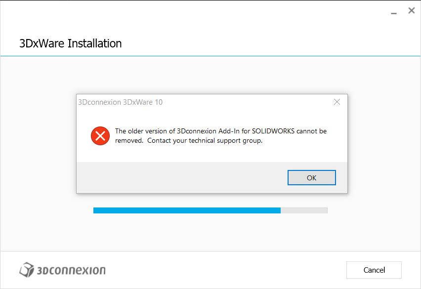

When I try to install the latest driver version, this message returns.
Can anyone help me?
Thanyou!

In all likelihood, the existing installation of the SOLIDWORKS add-in can't be uninstalled because there are files missing from disk (some "clean-up tools" will do that, for example). In this case, fix the installation issue by re-running the installer of the older 3Dconnexion software version, then reboot and do a clean uninstall.
If you do not have access to the installation file for the old version, have a word with our colleagues in the Technical Support team (contact details here). They should be able to help you sort it out.
