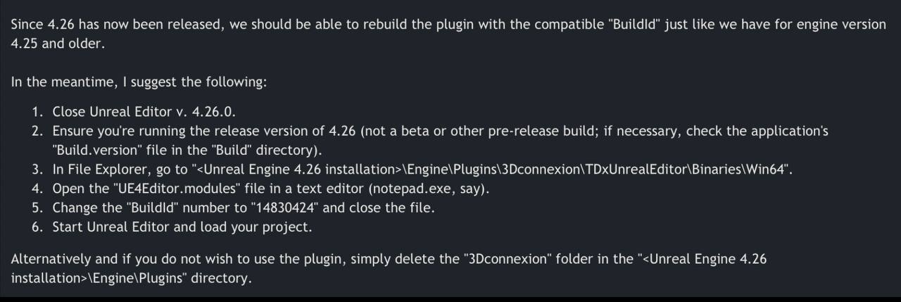

i tried the driver version edit but this didn’t work this time sadly.

Thanks for the info. I tried it too but it didn't work. In many cases, the other plugins can be used in 5.2 with the compilation working automatically. It is not an official release, but it is very important to be in a position to test it anyway.
