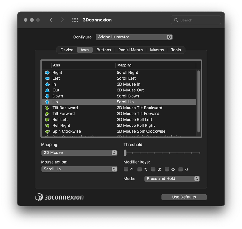

I just got a SpaceMouse Compact. Mostly for fooling around with Blender. It's working mostly as expected in there, though nothing happens if I press the buttons, regardless of how they're configured for "Any Application" - there's no default setting for Blender and I haven't set one up.
It is also not seeming to do *anything* in any other program, I've tried configuring it to scroll around in Adobe Illustrator and Safari and nothing's happening. If I map one of the buttons to the virtual numpad or the radial menu, that will pop up. So that's not exactly "nothing" but it sure isn't the expected behavior of "pushing the knob around moves my canvas":

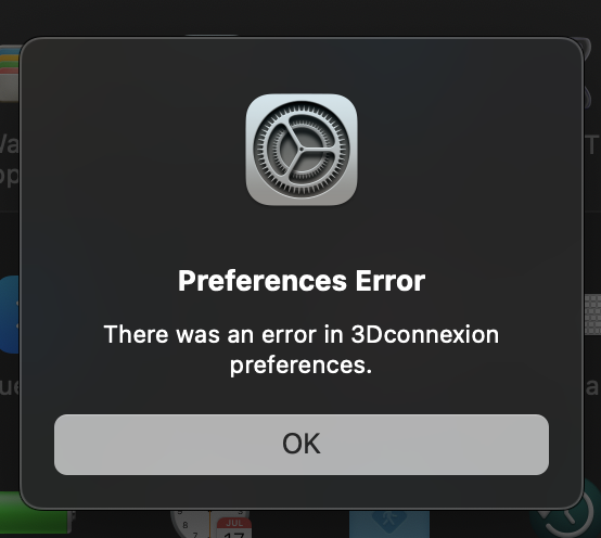

Also if I try to set the "mode" of an axis to anything besides "press and hold", the preference pane crashes, and won't reload unless I quit and restart System Preferences:

egypturnash wrote: ↑Sun Apr 16, 2023 6:05 pm It's working mostly as expected in there, though nothing happens if I press the buttons, regardless of how they're configured for "Any Application" - there's no default setting for Blender and I haven't set one up.
In macOS, Blender takes full control of buttons. This is by design of the application. To assign an action to one of the device buttons, you will need to configure it in the application.
Thank you for reporting this issue. It appears to be a bug in the driver (the prefpane applet) and we are tracking it with reference MAC-383.
