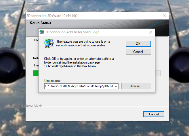

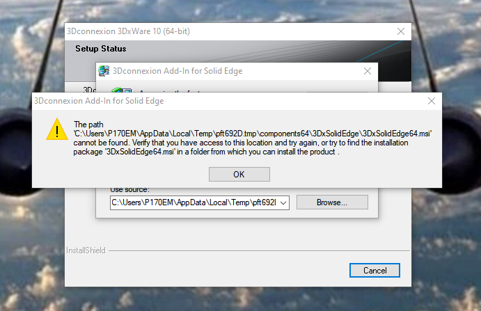

thanks for the reply, but still haven't found the file.
I downloaded the 10.6.3, which is the latest for the controller.
right clicked, and extracted to folder, run the .exe file and this is what i get -
Screenshot 2023-05-07 174114.png (201.94 KiB) Viewed 3502 times
it wont let me continue to install if i click OK
Screenshot 2023-05-07 174806.png (185.23 KiB) Viewed 3502 times

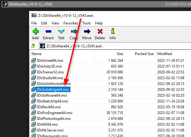

Downloaded the latest, 10-8-12 exe file.
right clicked and extracted to a folder in the :C drive/program:s folder.
open the folder, contains a lot of *.msi files including the required "3DxSolidEdge64.msi" file.
if i click the "install.exe" it starts to install,
then it still asks for the "3DxSolidEdge64.msi", so i point it to the extracted file location that's in "C drive/programs" folder,
then it just gives the same errors as above.
