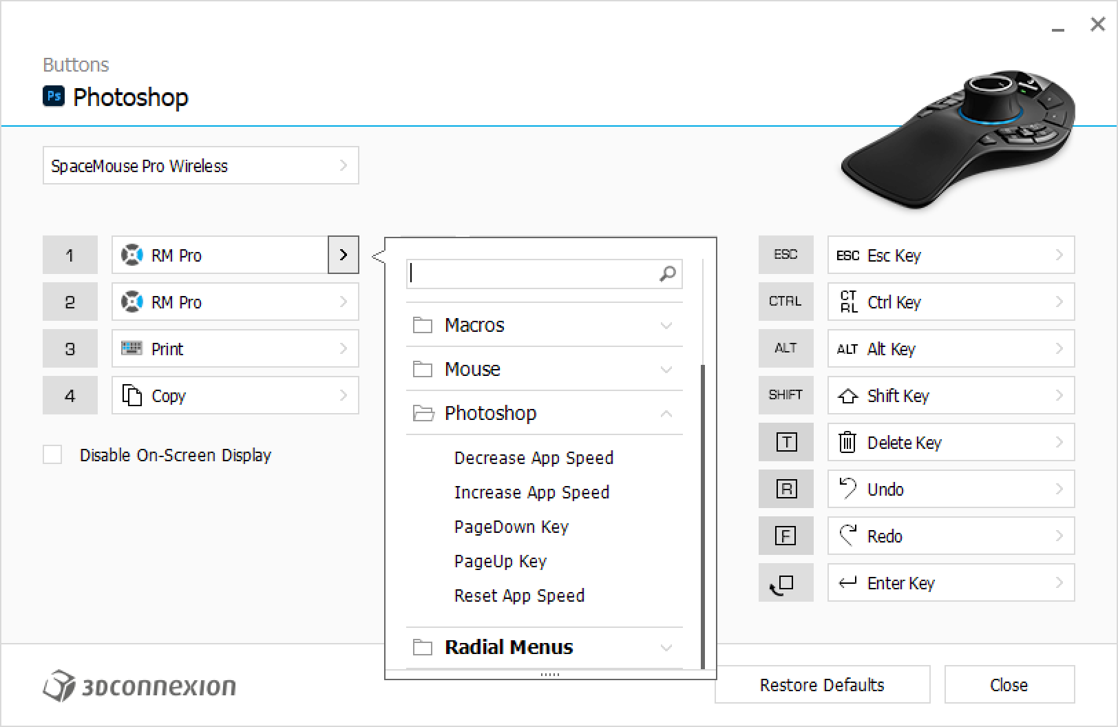

i am trying to find out if there are more application commands for photoshop (deselect, magic wand tool, paint bucket, etc ...)
i copied the plugin from 3dx location and pasted in photoshop plugin location. i have also setup automate and assigned a hotkey but i cant assign photoshop specific commands to any of my space mouse buttons and i didnt know if this is not possible at this time and the work around is creating a ton of macros to run commands.
any help is appreciated
photoshop version: 24.4.1 (2023)
3dconnexion version: 10.8.12.3545
SpaceMouse Pro Wireless: 3dx-600047

At this moment it doesn't seem to be an active feature.
You can program the tools pretty easily since many of them are keyboard hot keys but anything else would have to be a Macro
