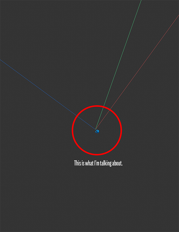

Hello, I'm running Mac OSX Ventura, using Cinema 4D 2023.2.0 (Build 2023.CL399467.56383). I'm also using a Spacemouse Pro. Everything is working well except for when I'm in a window in C4D every time I use the space mouse to navigate around the window a small blue icon appears at the centre of the window. Its quite annoying and distracting, is anyone else experiencing this and if so how do I turn it off? I'm running 3DxWare version 10.8.0 (3554).
I've gone ahead and attached what I see on screen. Any assistance would be appreciated.

There's a setting to control how the "pivot icon" is shown but there isn't a UI yet (we are working on it).
In the mean time, you can manually change the "PivotVisibility" setting as other having been doing to change the "MotionModel" setting (see here). The valid values for the "PivotVisibility" setting are: "ShowPivot", "ShowMovingPivot" (the default) and "HidePivot". You will want to use the latter.
