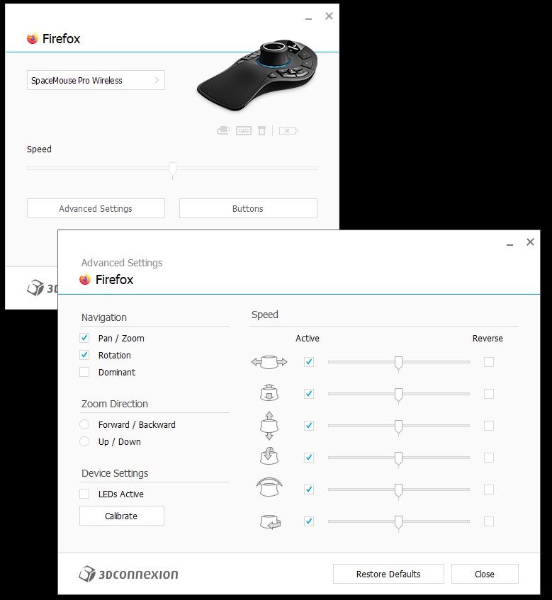

Right now I get used to my 3Dconnexion SpaceMouse Enterprise. Scrolling works fine in every app. But for some reason in firefox it's inversed. Anything I can do?

Run the 3Dconnexion Settings, click the Advanced Settings while Firefox application is active, then you can change the move direction.

Hi It is working ok now thank you for your help.
