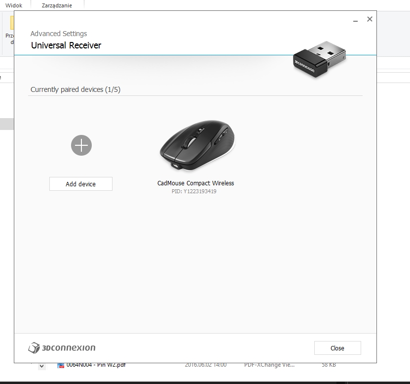

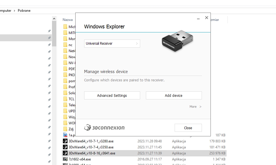

I see Mouse is paired with receiver:
3 receiver menu.jpg (123.56 KiB) Viewed 27159 times
4 paired devices.jpg (77.88 KiB) Viewed 27159 times

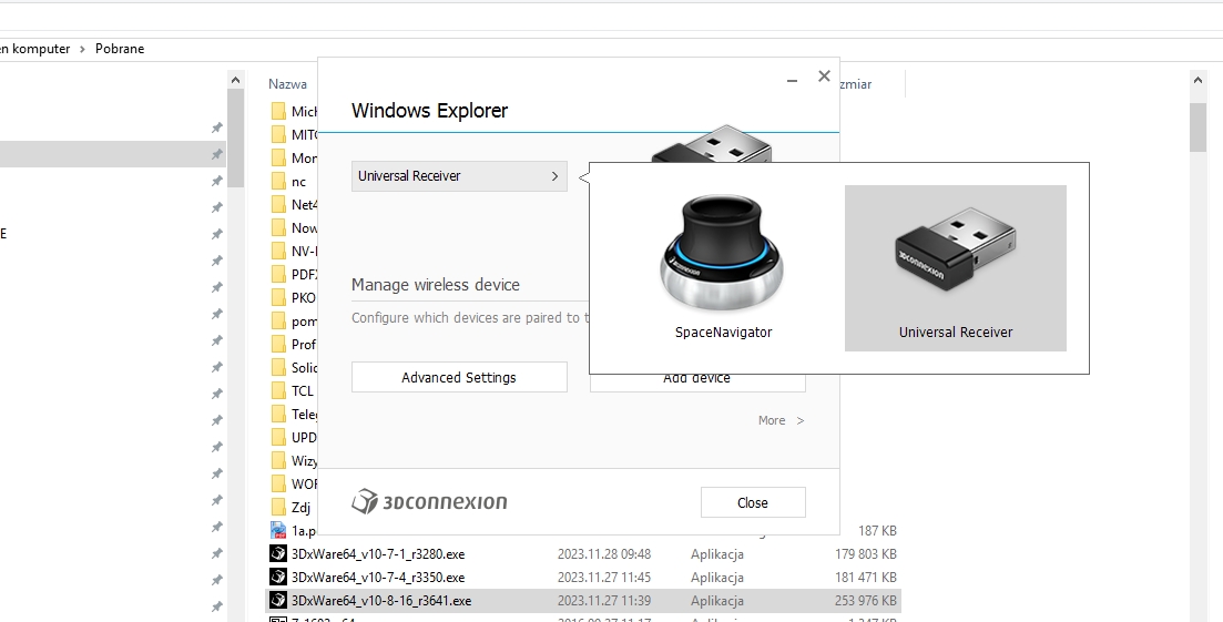

I also got SpaceNavigator and it works OK, with all functionalities. U can see in 3DxWare window there is no cadmause icon so I can't pick it and change settings of buttons etc:
2 navigator and reciever, no mouse.jpg (138.07 KiB) Viewed 27159 times
Any suggestions what to do?
Thanks in advance.
