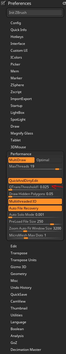

I noticed that 3DConnexion missed QTransThreshold1 which is available on Preferences/Performance/QTransThreshold1. Does anyone have similar problems on newest version of ZBrush and 3DConnexion drivers?
This is very important functionality of ZBrush software. Default settings is setted on 0.025.
