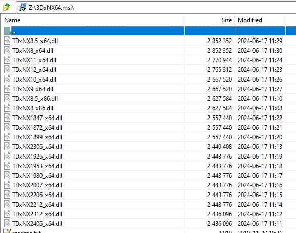

drkieffer wrote: ↑Wed Jul 17, 2024 5:55 am We are running 2206.6002 and 2206.9200 so that may be the issue.
You can use 7-zip archive manager to extract the 3DxNX64.msi file from the 3DxWare v10.8.21 installer. Obviously developers at 3Dconnexion didn't download the NX 2206.6002 or 2206.9200 installer from Siemens Global Technical Access Center (GTAC) website to compile the 3Dconnexion for NX plug-in source code with the NX Open C++ APIs/library from NX 2206.6002 or 2206.9200 to generate a working TDxNX22206_x64.dll plug-in for the updated specific build numbers. Contact the support here: https://3dconnexion.com/support/
