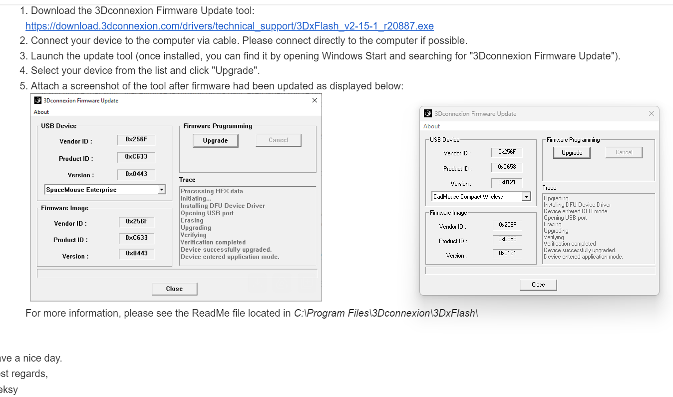

I have reply from techsupport to install the newest version of software and update firmware. Unfortunately, so far still not working properly.
