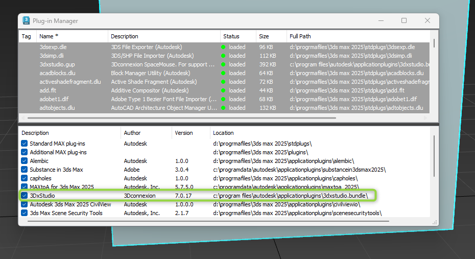

Hi Oleg
Yes it works fine with 3DxWare 10.9.1.
Please check in 3DsMax in plugin manager if the 3Dconnexion extension is installed and enabled (Customize -> Plug-in Manager).
If it's disabled please enable it there.
If it's not there please reinstall 3DxWare, be sure that when installing that 3DsMax plugin is checked.

Re: 3DS Max 2025.3
Yes, everything worked, thanks a lot for the advice!
The only question is why the update didn't work and the plugin really wasn't on the list...
I can no longer work without the 3Dconnexion device, I feel discomfort on a biological level.
To anyone who finds themselves in a similar situation, use the instructions given above...
