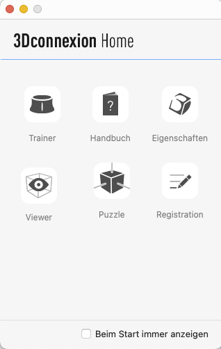

Have a look at this post. You may have a corrupted system extension installation. If the system extension is not installed correctly, button assigned to keyboard shortcuts will not work.
If the system extension is installed incorrectly, you will see a warning in the "3Dconnexion Home" application.

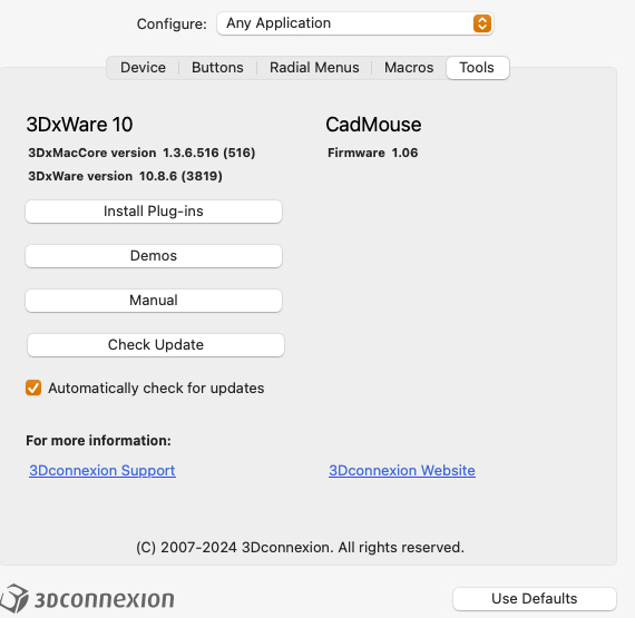

Is this (1.3.6) a correct and current system extension ?

where can I find a list where I can check if I have latest Firmware ?
original Space Navigator FW 3.18
CADMouse USB FW 1.06
Enterprise FW 4.42
if these are old - would they update when I attach them to a PC ?
(and if - only while updating the Driver ?)

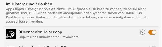

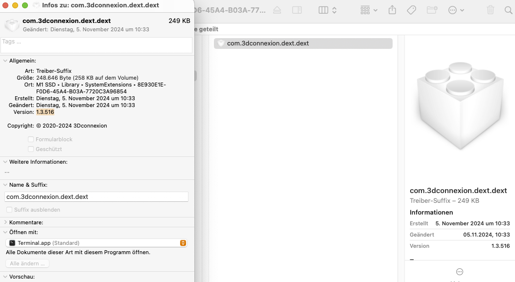

Sorry,
not 3D Helper ....
this is my DEXT : Version 1.3.516

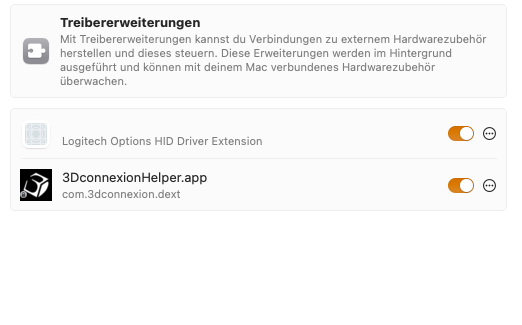

And yes, I also suffer from dysfunctional Button Mappings ....
But my 3D Connexion DEXT is activated.
Finally, as when I installed the driver again/over, after it did no more work after I upgraded to macOS 15.2,
it threw an error messages while asking for permissions while installing.
After some reboot cycles + second driver installation I was able to activate the DEXT in macOS Settings manually.

BTW,
why is 3DConnexionHelper.app .... an "Object from unknown Developer" ?

All looks good. The build number ("516" in your case) of the system extension matches the installed version of 3DxWare 10.
That "unknown" is remark is a concern. All our software does through Apple's notarization process. 3Dconnexion has the required developer credentials as issued by Apple and they are valid.

Based on the referenced thread I checked the 3Dconnexion Home app and indeed it showed that the system extension was not active. I was completely unaware of this problem because I never use this app. I only ever use the 3Dconnexion pane in System Settings, and I really think that this extension check should be performed there too and the warning should show up there.
Oddly, when I then went to System Settings > General > Login Items & Extensions > Driver Extensions, the 3DconnexionHelper.app entry was properly enabled. So there is a mismatch between what System Setting says and what 3dconnexion Home sees, which is very confusing.
I then tried to toggle the extension off and back on, but that led to an error message about an invalid state when re-enabling. I then rebooted the system, and that finally made the system extension load in a way that showed it enabled both in System Settings as well as in 3dconnexion Home. At this point, the buttons started working as expected in Fusion 360 as well.
