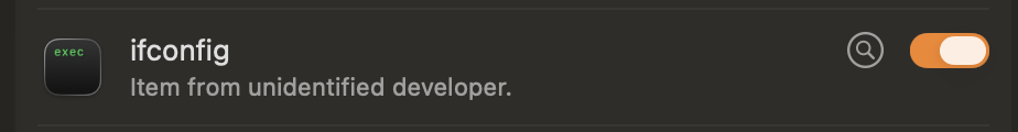

So why wasn't it configured on my system? Because of years of random junk installed on my machine and my obsession with disabling LaunchDaemons that I don't specifically understand and want to run. At some point, I had toggled off this seemingly random entry called "ifconfig" under Login Items and Extensions in my System Settings:
Toggling it on (or better yet, Loading it via LaunchControl, which is how I initially identified ifconfig as a critical 3dconnexion config), allowed 3DxNLServer to start successfully after a reboot.
