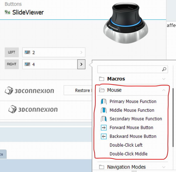

My suggestion would be to add single tick of MouseWheelUp and MouseWheelDown as discrete events to the list of shortcuts in the GUI - then in XML it this could be handled with something like RepeatStyle and MaxEventRate (possibly - some reference here) It would be useful to easily bind these wheel events to buttons as well.
I'm not sure if MaxEventRate just applies to KB_Keystroke or could also be used for this theoretical HIDMouse_Wheel_Up function I'm proposing. (Afaik there is no pre-existing HID hex code I could put into KB_Keystroke to emulate a discrete wheel up/down event.)

wilco
Posts: 16
Joined: Tue Oct 21, 2025 2:36 am
Re: Parameters for ActionID = HIDMouse_Wheel ?
Post by wilco »
Screenshot 2025-10-29 004718.jpg (59.16 KiB) Viewed 1217 times
