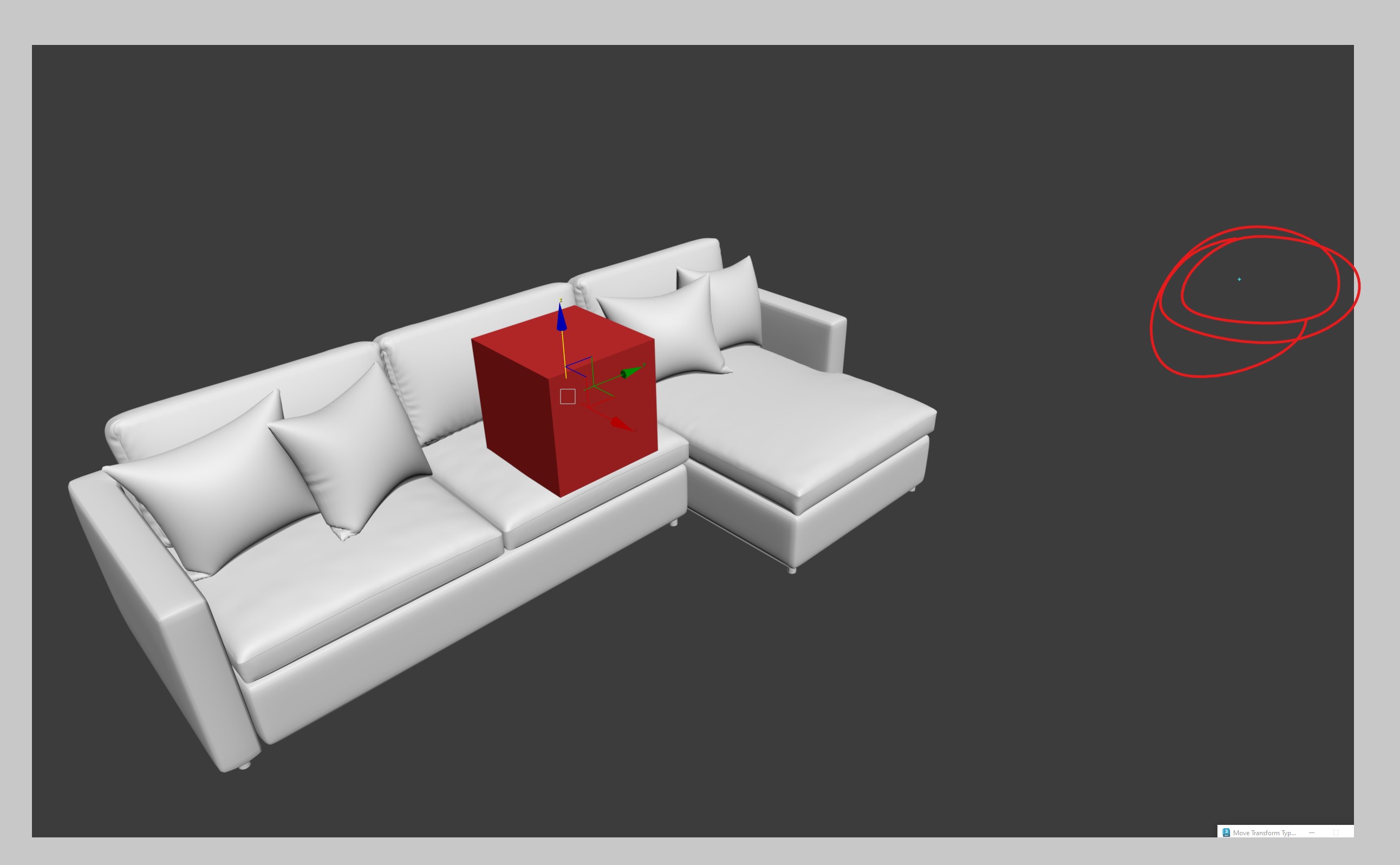

hi there :)
please see the attached file (3ds Max).

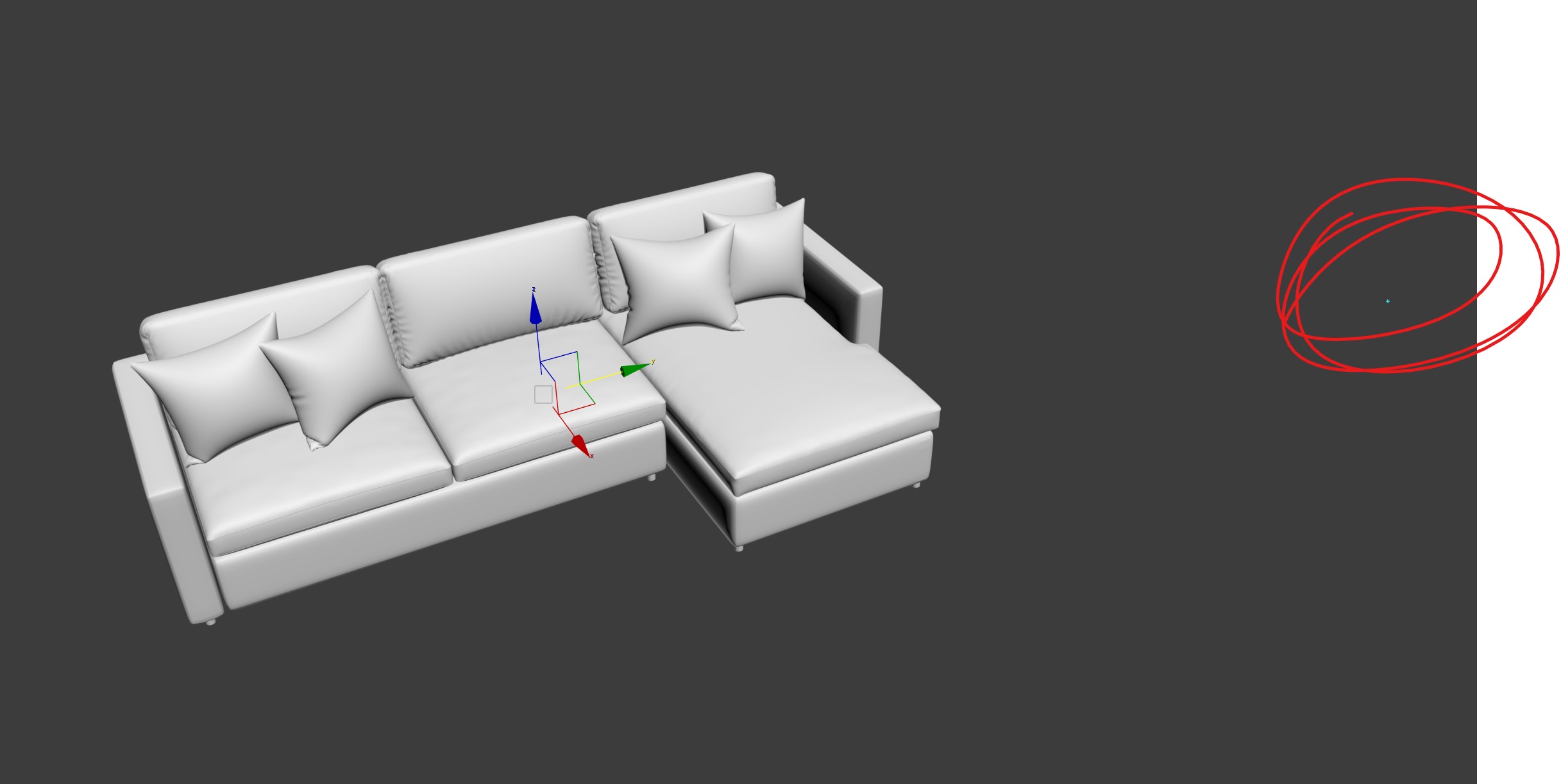

when I "Z" on the sofa to zoom/center it, then switch views (top, right, etc.), and go back to perspective view, the blue focus point is still miles away, from another dimension, staring blankly at the sofa with its little supid eyes ^^
why does this happen?! (honestly, it’s just a simple sofa, I’m 100% sure about the modeling....it even happens with a simple box, look !)
(using Max 2024 / latest drivers installed)
best regards,
Nicolas
